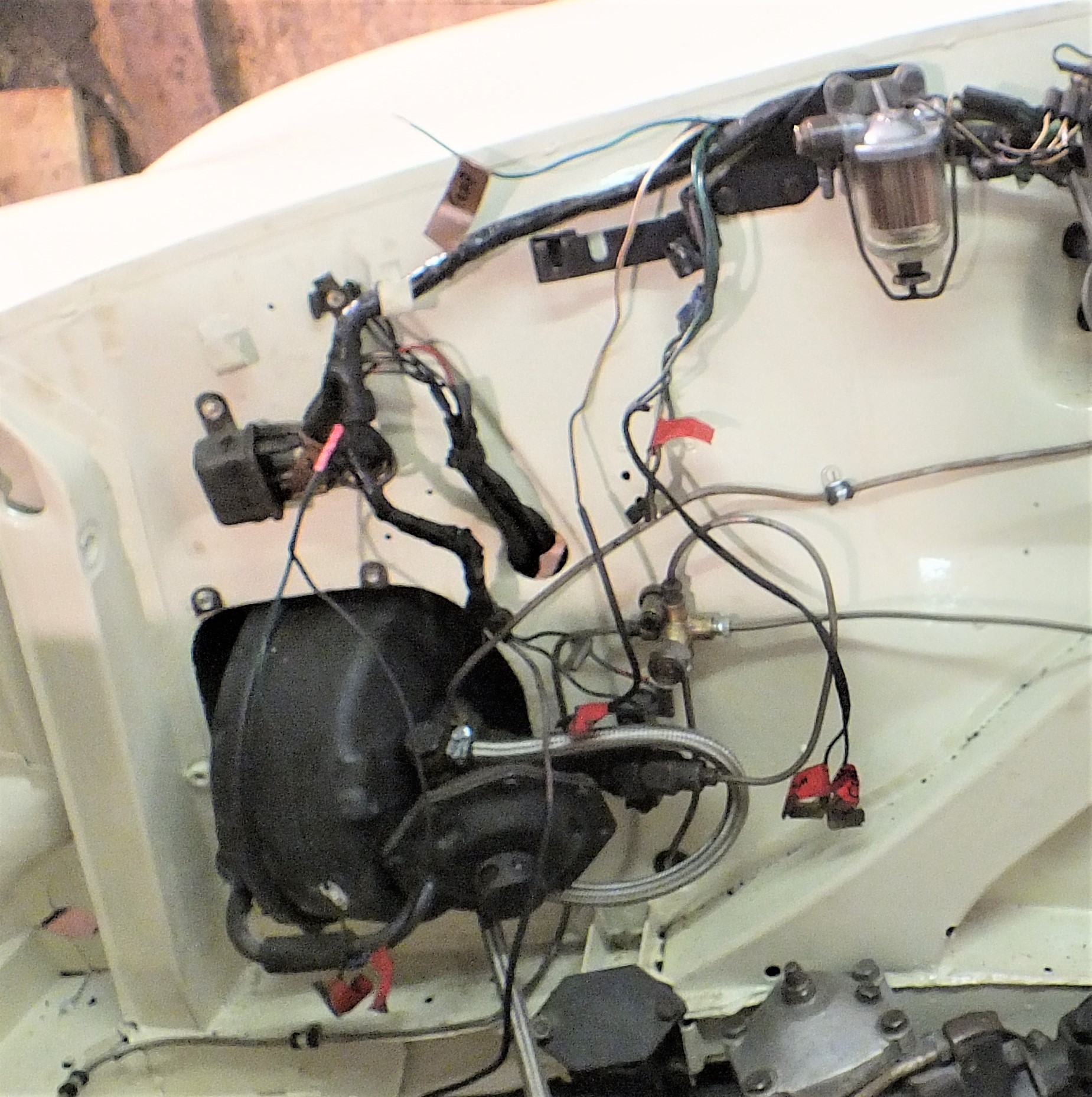

The servo is quite difficult to get to as it is in the engine bay on the right side inner wing below the distributor. To gain access there are several pipes and wires that need to be moved and taking the distributor out gives you room to get at things. Some might even remove the carburettors but I think this would give you more room but take a long time. The servo is held on to the inner wing by three or four bolts that hold not just the servo but also the servo shield which sticks out in to the wheel arch. From memory the bolts are only accessible from inside the engine bay and depending on how long they have been there could be rusted in due to the fact the threads are exposed to the elements inside the wing. To remove the servo I would expect it to take a couple of hours and the same to replace. A tip when refitting is to connect all the copper brake fluid pipes to the servo before you tighten up the bolts securing it to the inner wing. This allows you to jiggle the servo around to get the pipe threads started and helps not to cross thread the pipe ends.
Below is a photo of the servo in place on the inner wing obviously without the engine in place which makes it a lot easier to remove and replace.

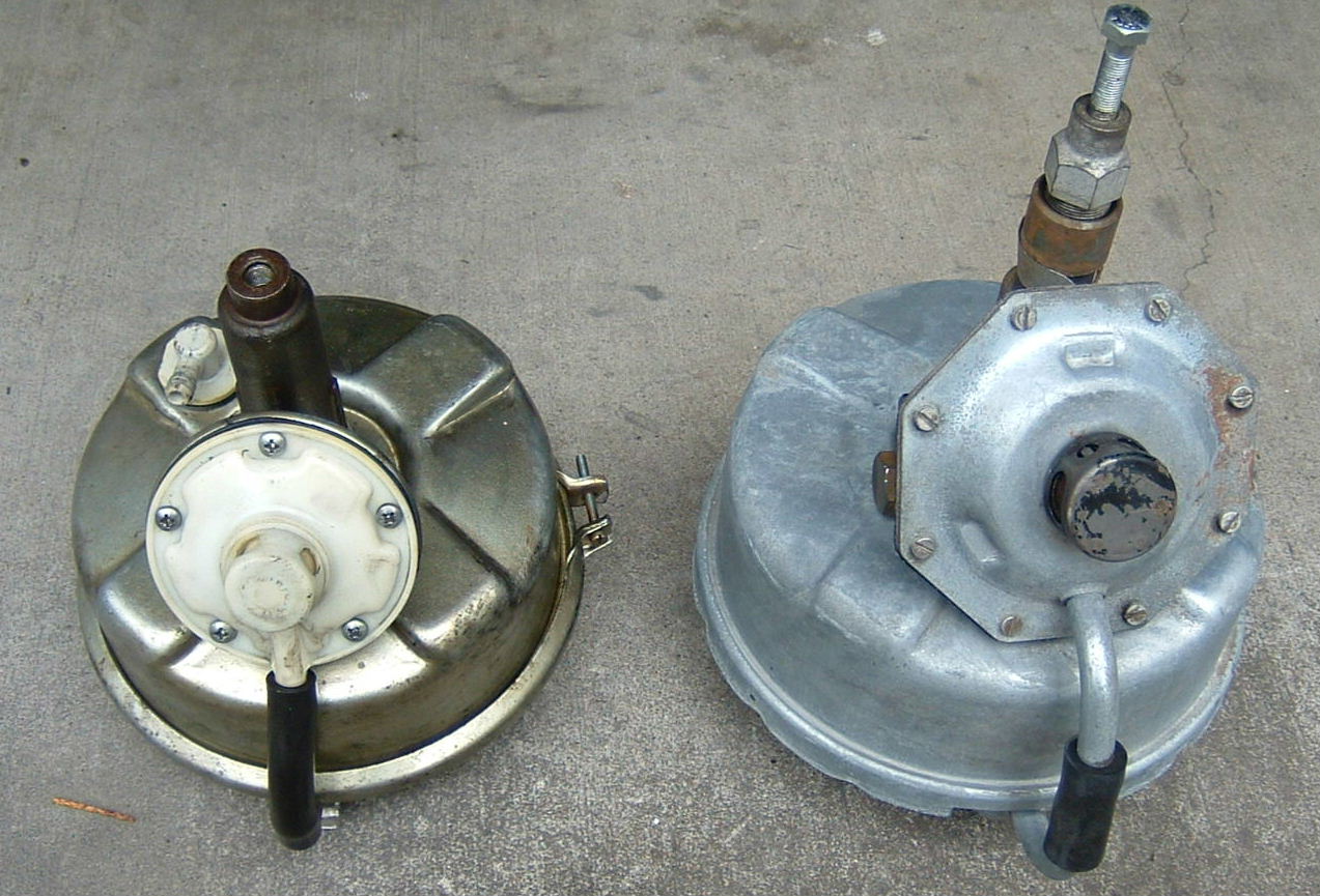

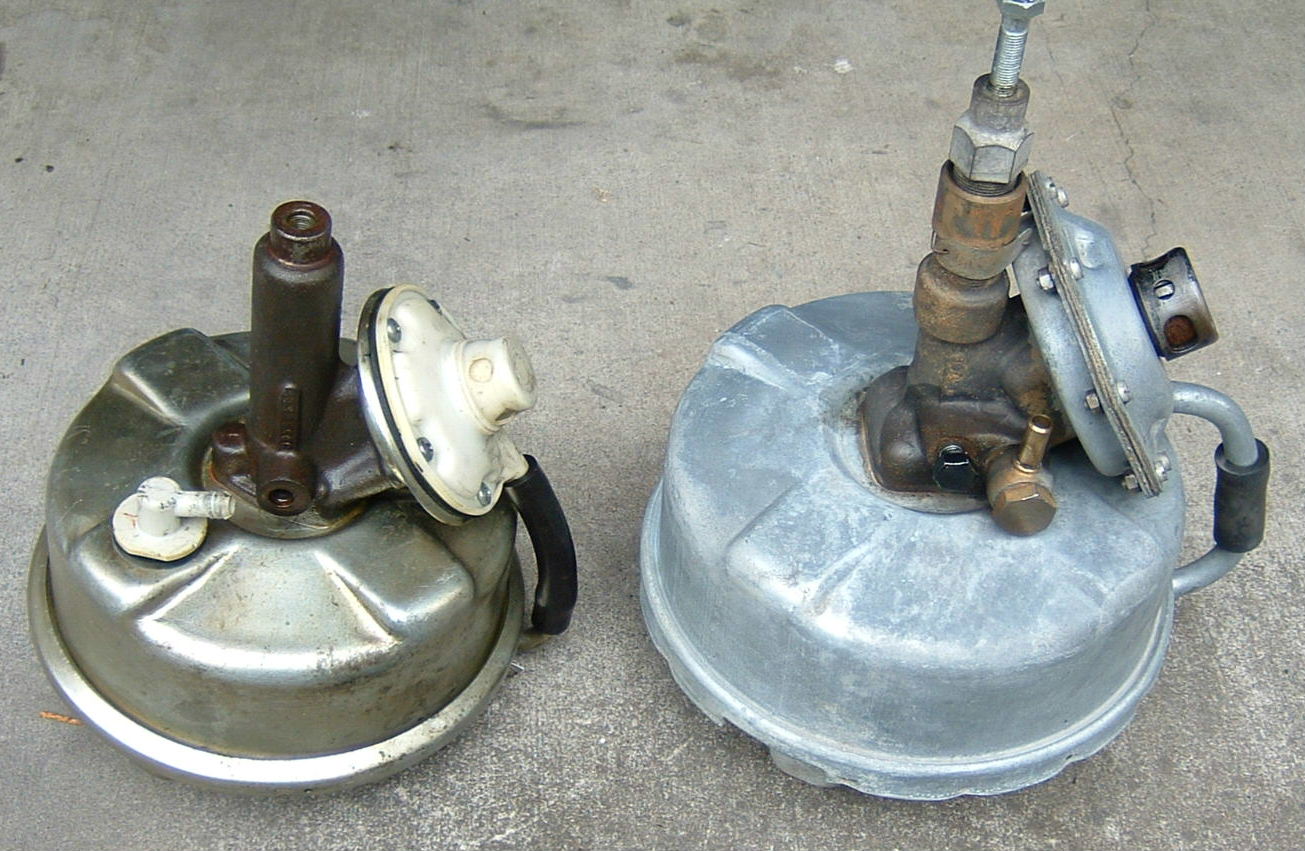

And just for reference here is a photo of two servos, the one on the left is a commonly available replacement and the one on the right is the factory original. When my servo (after 56 years!) developed a vacuum leak (or so said my shop) they replaced it with the one on the left which as I understand it requires a bit of adjustment to the mounting and plumbing but it seems to work fine for the last 5 years. I guess it is possible to get all the bits to overhaul the original but not all do that now.

Posts: 527
Re: brake servo assistance
It helps if you unbolt the servo shield from under the front wing to gain a bit more access, not an easy job!
