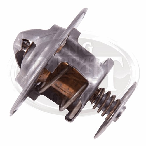

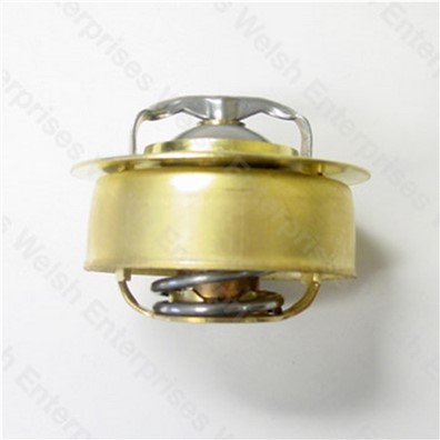

I am wanting to change the thermostat in my S Type. The variety out there is a bit confusing. Looking for one that is 74C and I believe it should have a feature that blocks off the bypass passage when it hot and open. Here is one offered by Barretts and one offered by Welsh Jaguar. Which works properly? The link shows even more choices.

You will need the stat that uses a shield to block off the bypass slot.
Re: Engine cooling thermosats
This is the correct thermostat. When open closes the bypass port and forces 100% of coolant via radiator. See 2nd item genuine Waxstat from Barratts.
