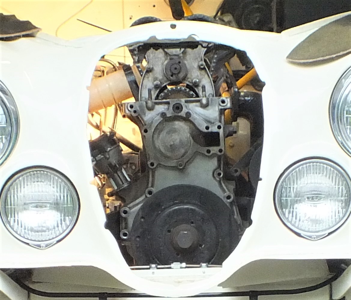

Generally it is not the water pump gasket but the water pump itself. There is a small breather hole just above the bearing/seal which is where the water seeps out of. (Indicated in the photo by the yellow arrow.)
This can be caused by the seal on the impellor leaking allowing water to go to the seal and out of this hole. If this has gone then you are looking at a new water pump as the seal and bearing are very difficult to change and the chances are that the water pump bearing will have gone anyway. You might even find the impellor is corroded as it is made from Alloy.
Also check that if the bearing has gone that the impellor has not come into contact with the housing and caused a deep enough score mark to allow water to run into the chain area. You can see the scoring on my engine in the photo below which was due to the bearing being worn and the impellor not running true. This was not bad enough to cause concern and a new water pump allowed better clearance and a straight impellor blade.
Replacing the water pump is not that hard once you have the radiator out of the way and if you remove the front grill at the same time as this allows direct access to the front of the engine. My only words of caution are to protect the back of the radiator from the front of the fan with a sheet of cardboard as it is very easy to put a blade of the fan through the back of the radiator. When removing the front grill the nuts and bolts are very small threads to be careful to soak them with a good lubricating solution before trying to undo them and lastly the radiator shroud has to be left hanging over the fan when removing the radiator as there is no room to remove it between the radiator and fan blades but that also means you have to remember to hang the shroud over the fan before lowering the radiator with cardboard protection back into the car.
