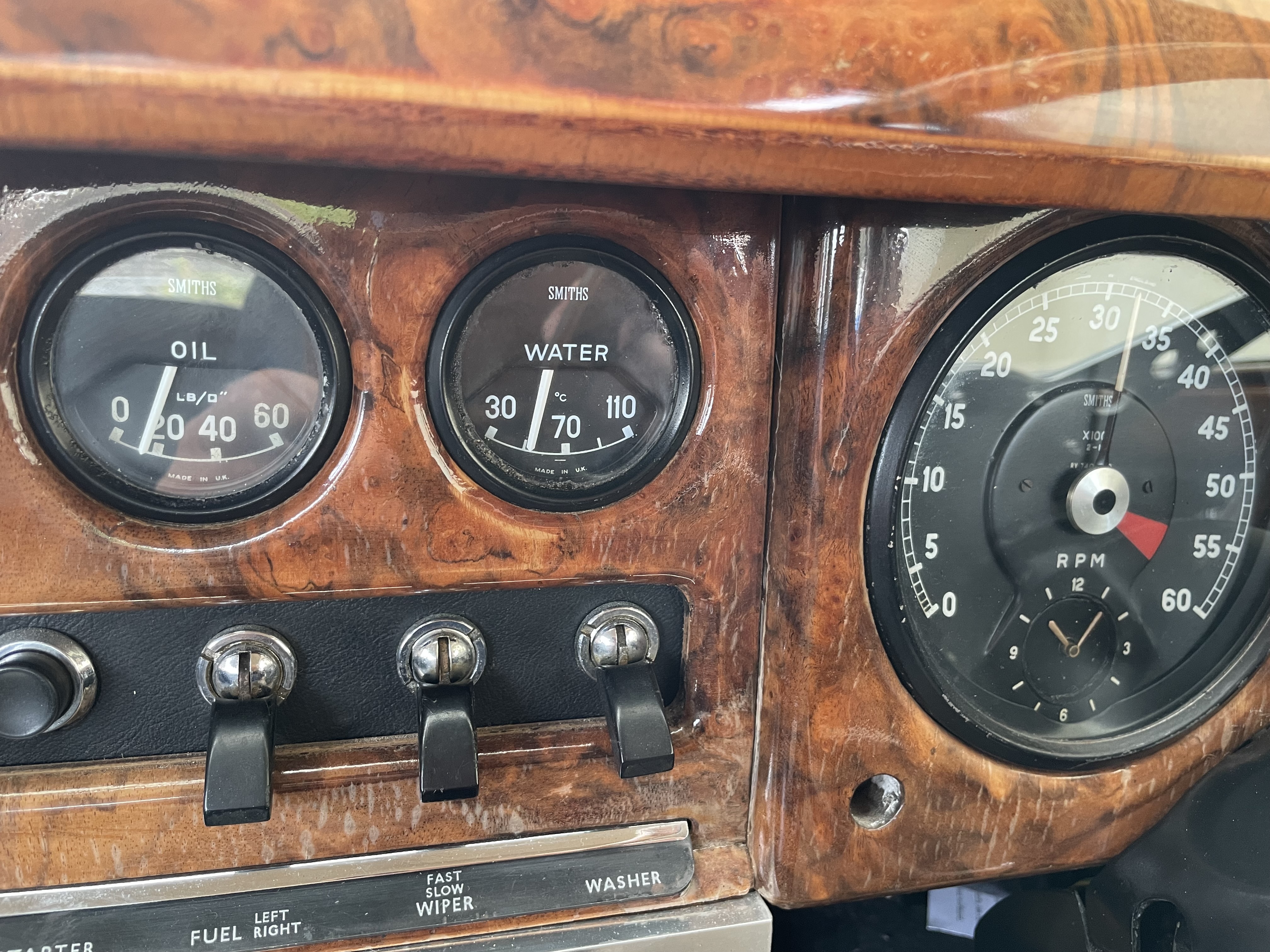

A bit disconcerting but recently I had a massive drop in oil pressure. From a normal running PSI of around 40 it dropped to below 20 at 3000 rpm and whilst sat at traffic lights it dropped from a normal 20 to zero.

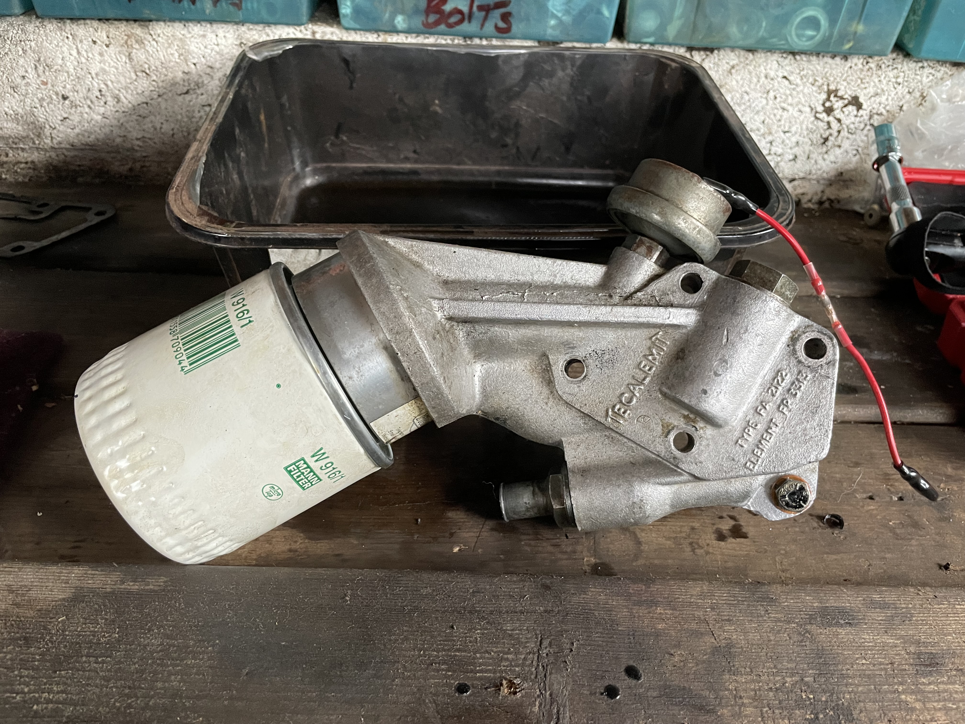

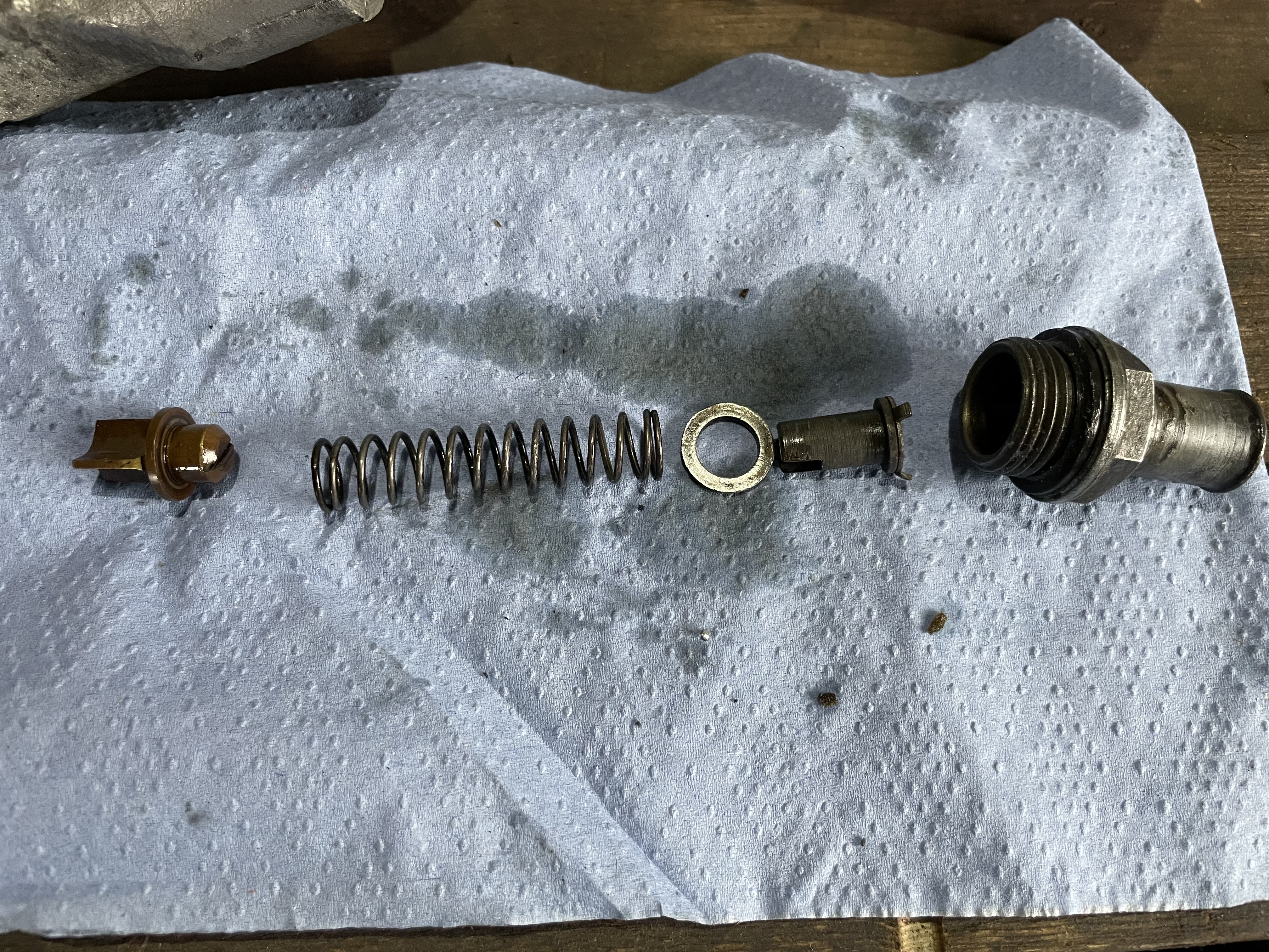

Last week I bit the bullet and got under the car and removed the oil filter housing from the side of the engine. Not a difficult job other than access to the five ½ bolts. Once the bolts were out (you have to leave the bottom front bolt in situ as it fouls on the steering box) a screw driver to release the jubilee clip on the bypass hose and the housing slides out. On the bench the housing was checked, the pressure release valve was stripped and cleaned and there was nothing obviously wrong with it. The housing was refitted (not forgetting to insert the lower front bolt first before offering it up) and everything tightened. Checked the oil pressure and it was still showing no pressure.
OK next was the oil pressure sender. Not a cheap part as they are nearly £90 at SNG which is why I went for the pressure release valve first, but I bit the bullet and ordered a new one. It arrived today and although again it is difficult to get to, an 18mm spanner with one arm down the front of the carbs and the other down the back and I was able to release the old and fit the new. Started up the engine and Hey Presto, oil pressure back up to 20 on tick over and 40 at 3000 rpm.
