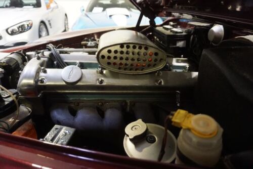

OK I am going to start with WTF is that air filter? Then quickly move on to the Alloy radiator and state this might be show quality but certainly not Concours.
Not worth $75,000 but the name Ralph Lauren might add a bit to the price.
In the write up and this makes me laugh every time I see someone waste their money on getting a garage to do this for them it states VALVE and SEATS UPDATED to run on UNLEADED FUEL. The XK Engine was already ready for Unleaded from the factory for Gods sake due to the head being Aluminium and the valve seats hardened steel inserts.

300k on restoration!! Looking to at the presentation of the engine bay and the boot carpets I'd be asking for a refund.
