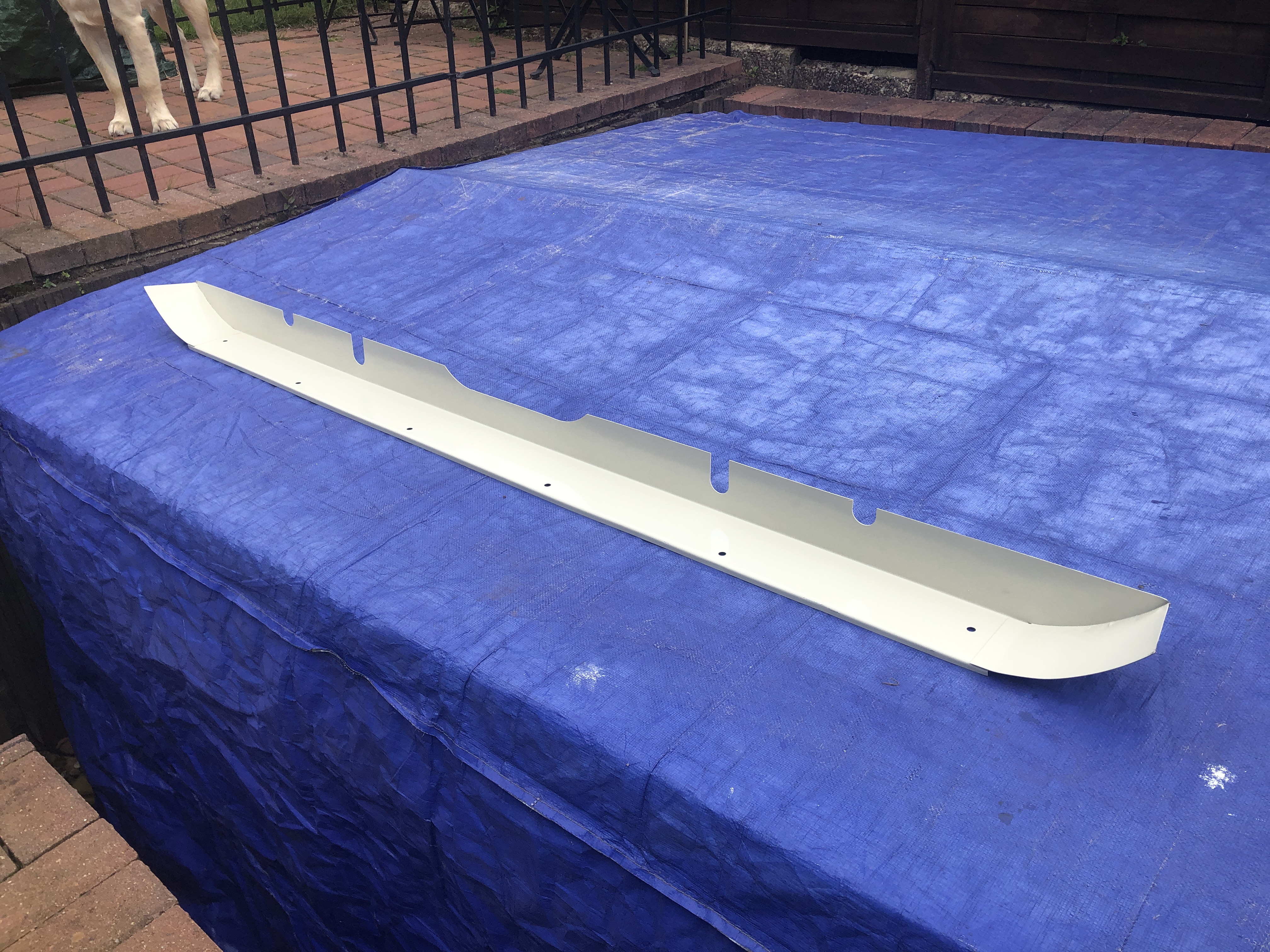

A couple of weeks ago I purchased one from EBay. A new never fitted Martin Robey copy that had been sat in a garage for several years after the sale of the owners Mk2.

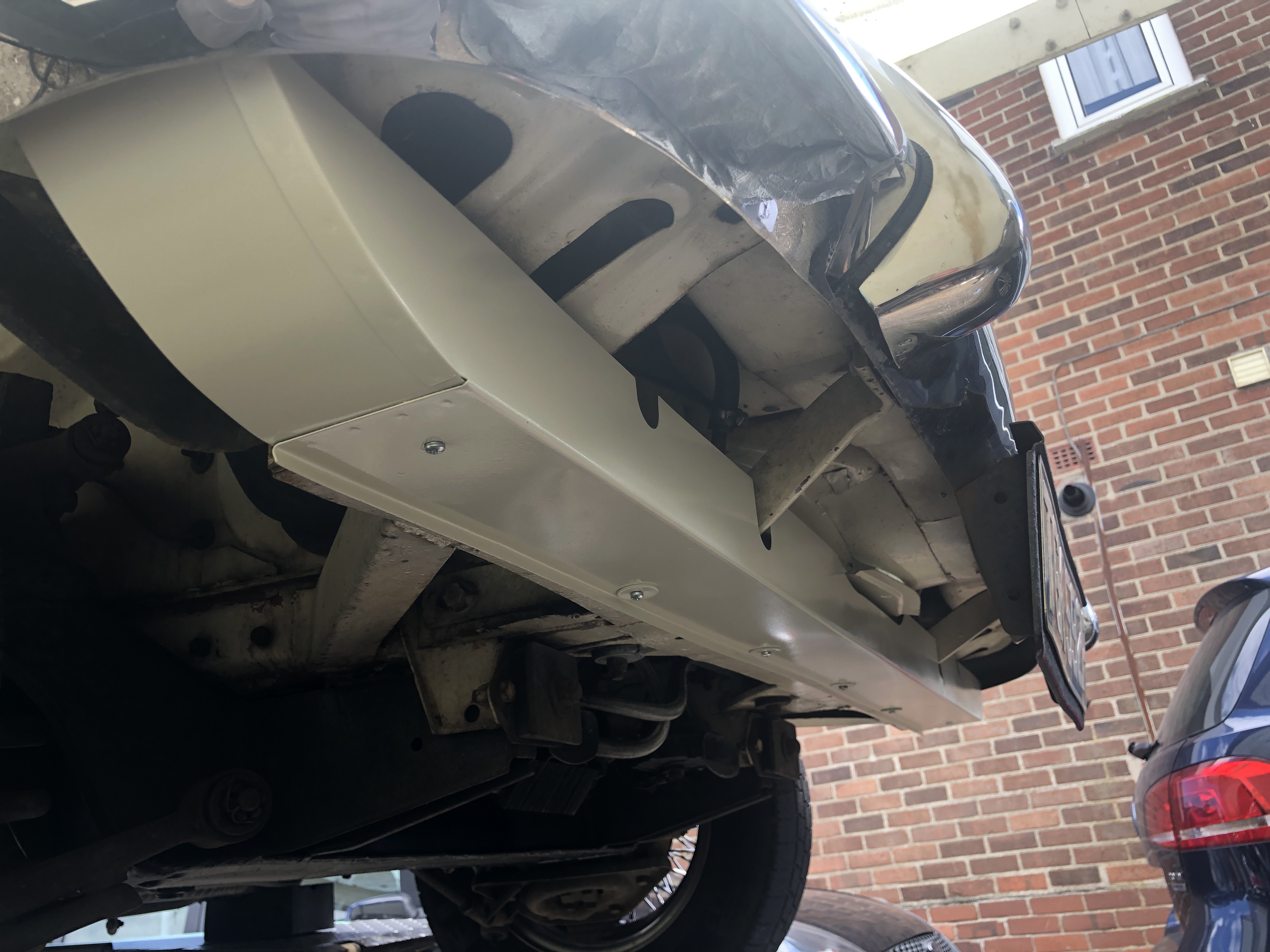

Got it home and gave it a rub down and paint in the Old English that my car is and fitted it with self tappers to the front radiator cross member. Very easy fit and it cleans up the front underside of the car nicely.

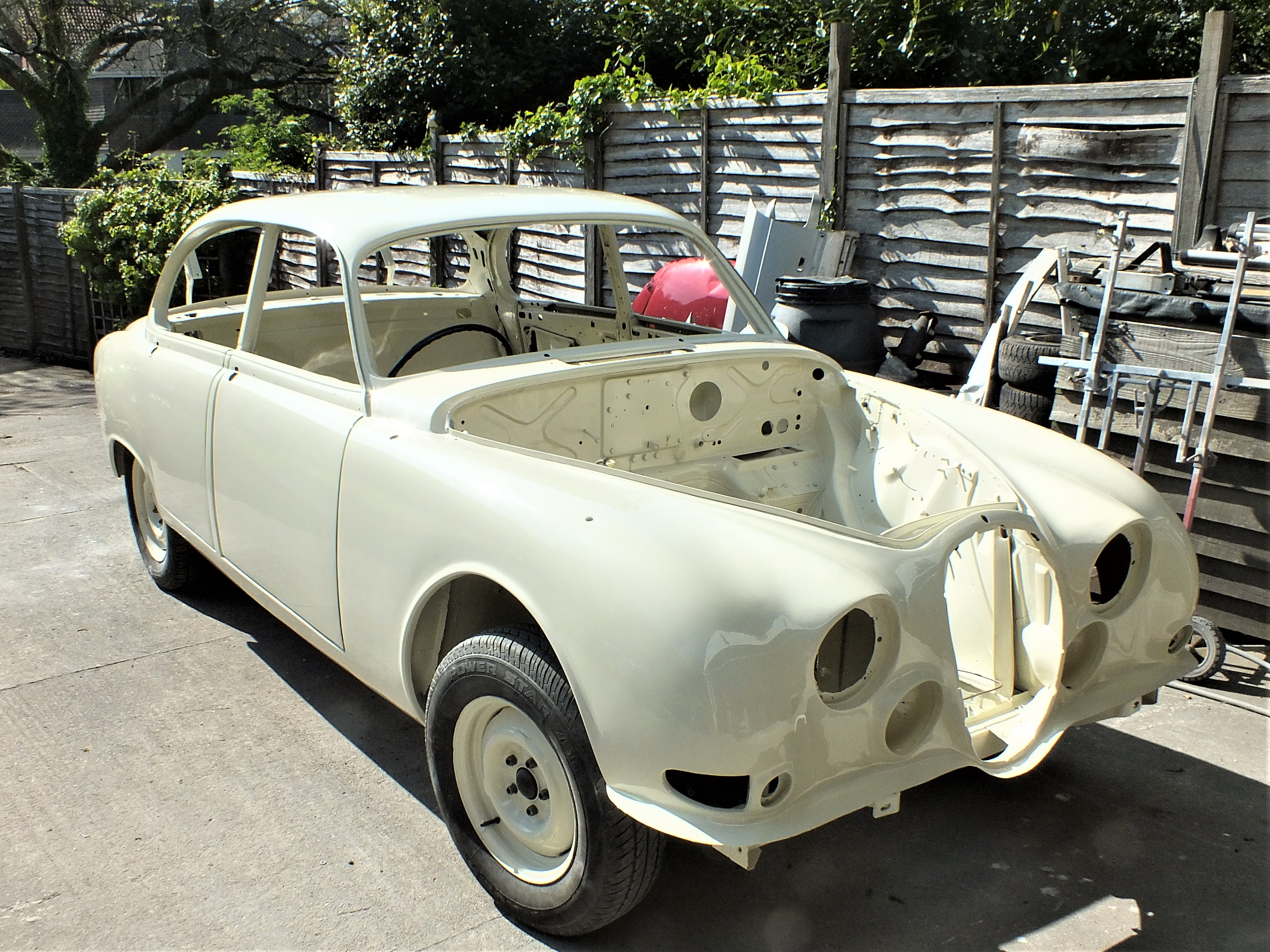

Rubbed down then give several coats of Hammerite white then several coats of Old English white. Before fitting the cross member looks very busy. Compared to when the valance is fitted. Head on view fitted.

I think all S Types should be fitted with the Valance but it is such a flimsy piece of thin mild steel held on with 7 self tappers that I am not surprised that the original piece on my car had disappeared.
It is only a cosmetic cover piece and I can see previous owners of our cars damaging it, ripping it off or it rusting out and not being replaced. Very easy to fit. Mine cost half of the cost of a new one from SNG otherwise I doubt if I would have bothered as it is not structural nor protective of a vital part or area.
Purely cosmetic and a collector of dirt and detritus. No wonder that they rusted out but with our cars now being better maintained and cleaned it should last longer. My next job is to spray the inside that cannot be seen with Waxoyl to protect it.
