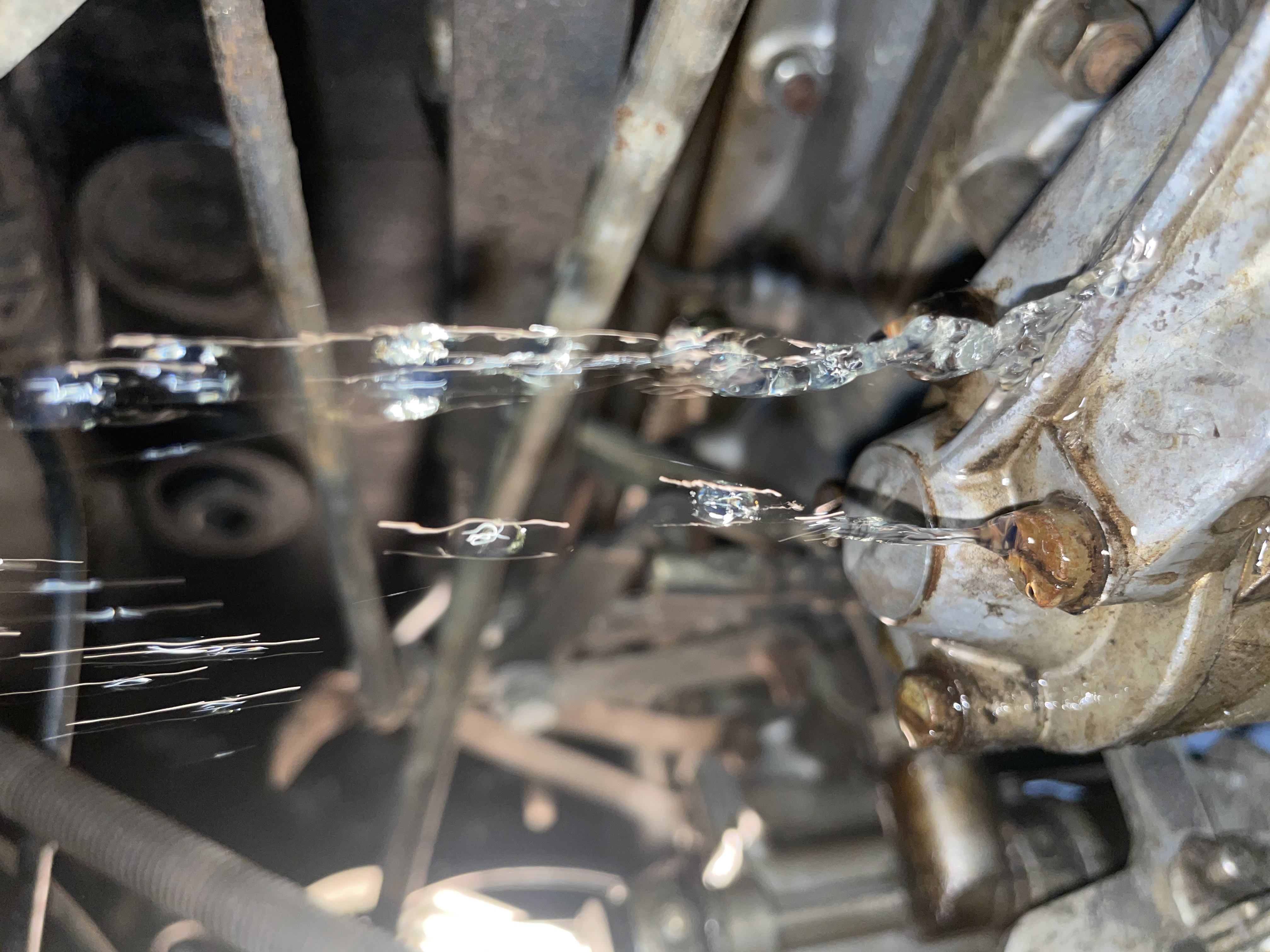

I cleaned out the pot valance and removed and cleaned the needle.
It did not help.
Seems to me the fuel is leaking from the bottom of the Carb.

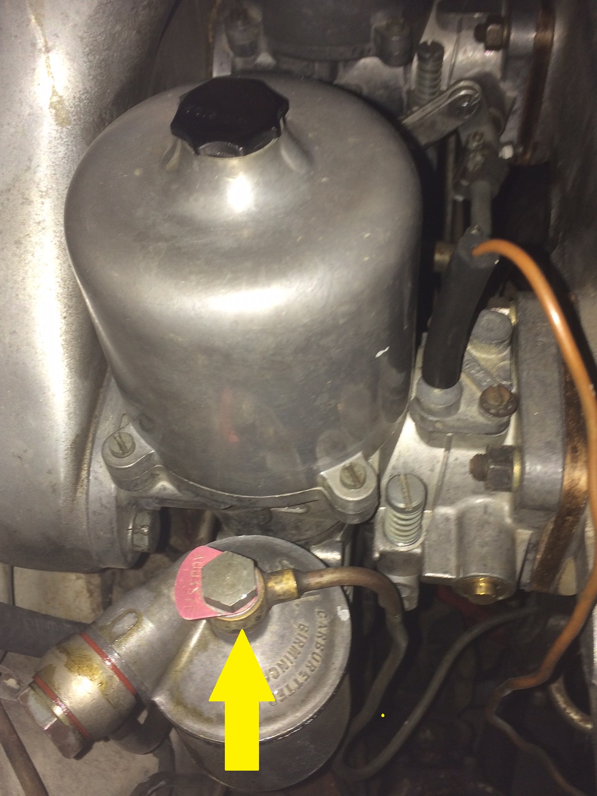

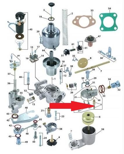

Replace 4 the diaphragm in the picture above, Do both carbs while you are about it. If one has gone the other will follow.
