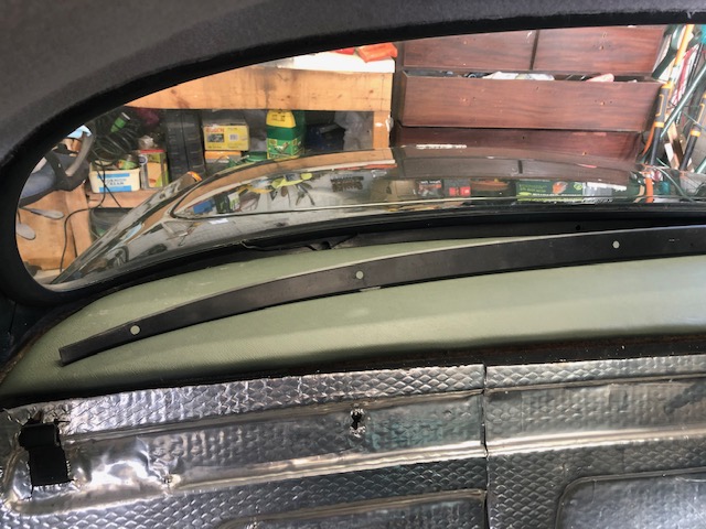

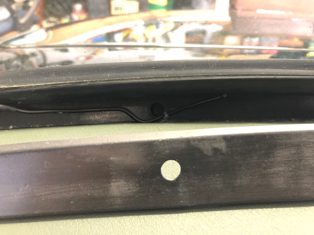

Hi! I'm nearing the completion of my 5 year restoration ('68 S-Type 3.4 Auto) and need to re-trim and re-fit the pressed steel trim piece that goes at the bottom of the rear windscreen on the rear parcel shelf. I can't remember or find any clips that will retain the trim to the car. I can see holes in the steel that align with the same diameter holes in the body but can't think how it attaches!
Any help gratefully received!

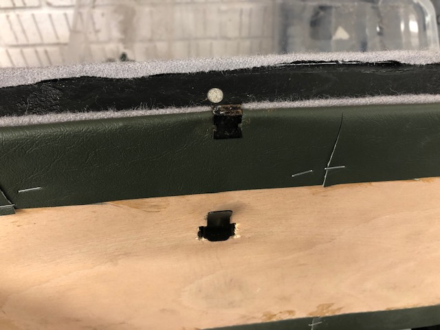

The fillet in my car is held in place by clips that were put in place prior to upholstering.
Here is an old ill fitting original. You can vaguely see a clip between the ceiling light reflections.

Many thanks for the tips. With your help I've worked it out - I thought that the trim should attach to the car body underneath the rear screen because the holes align but it does make much more sense for the trim to attach to the parcel shelf itself. I've used some U clips that I think came off the front seats (and possibly are the same as what were originally used). End result below:
Re: Rear parcel shelf trim clips
Yep now I have seen your photos it has reminded me that that is how mine is attached with those clips. I covered this piece with the same vinyl material that I covered the rear parcel shelf with so it is all black.
The Fillet Piece clip is a slightly different shape but who cares as long as it holds it firmly in place. Mine is attached as original.
