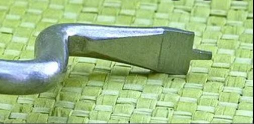

Wise advice especially if you have rust. If you take a wheel to MWS or a wire wheel rebuilder the first thing they will do is cut out all the spokes. Examine the hub & rim. If serviceable put them in a cleaning cabinet & re lace the wheel with new spokes & nipples ~ true & tension. Rechrome before if necessary. or repaint afterwards as necessary. On painted wheels you can save some money going this route. If hub & rim need rechroming you might as well buy a new wheel.
Nipples should be removed or tensioned with a large cranked split edged screwdriver/nippledriver with central protrusion for easy alighnment. And I mean large & fully cranked. Not a bicycle wheel semi cranked screwdriver.

All the pros work from inside the rim with cranked drivers like the above on the head of the nipple. The size of a single size wheel brace. None of them work on the outer faces of the nipples. I have no idea where they get those cranked drivers. MWS could tell you. They are what is used on the production lines unless there is now some sort of powertool. They lace a wheel very quickly. I guess if you do it every day practice makes perfect.

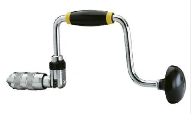

It's a long time since I went through MWS
But their tool at the time looked like this Stanley Drill but no chuck & an end nipple driver as below.
