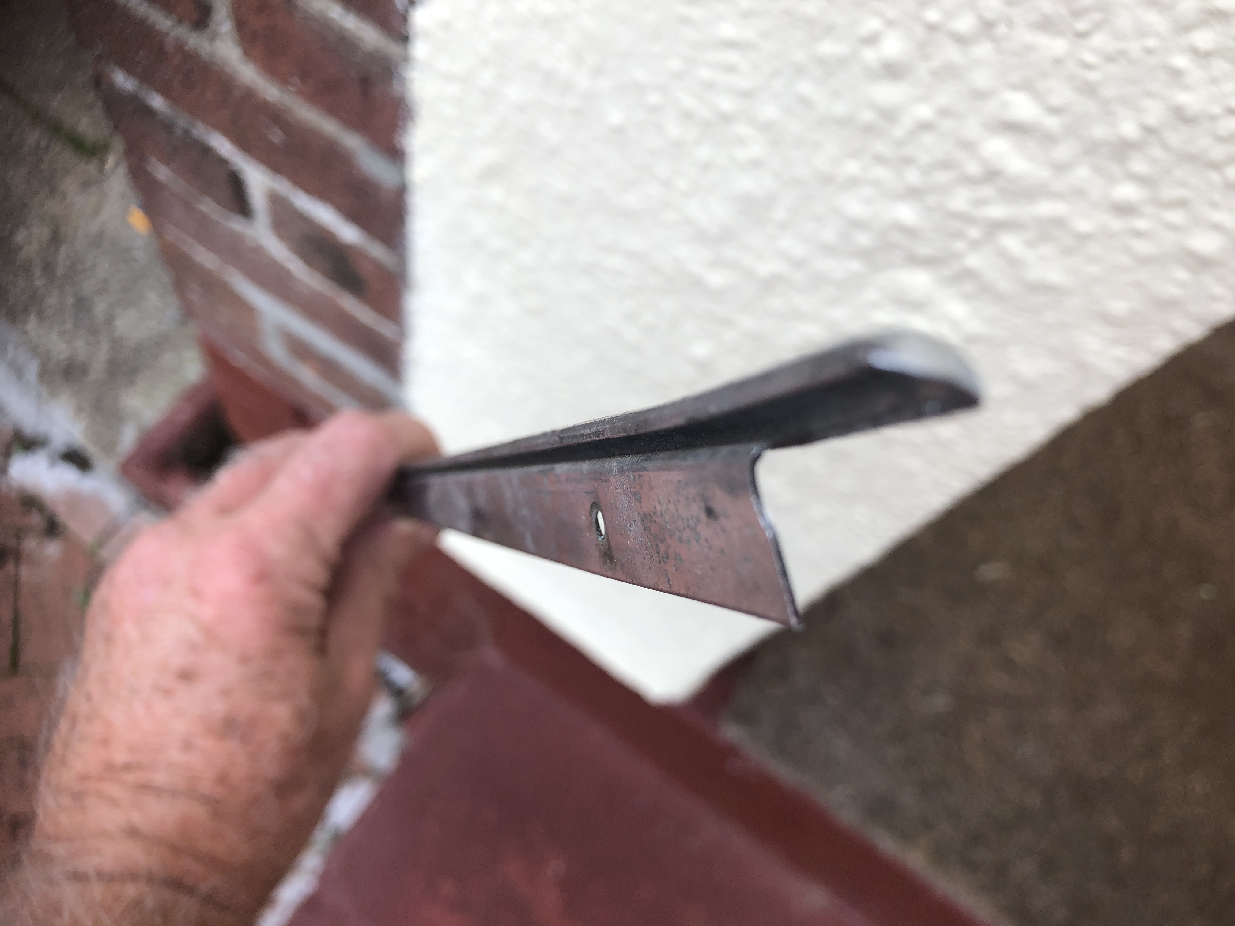

I’d like to replace the side window glass scrapers on P1B79909DN and could use advise from those who have been deeply inside their ‘S’-type doors,
The part is BD.21073/3 “Seal (Neoprene) between top of door and glass”.
First, it has a profile and I would like to know who supplies one that fits properly and stops water from running down the outside of the widow into the door.

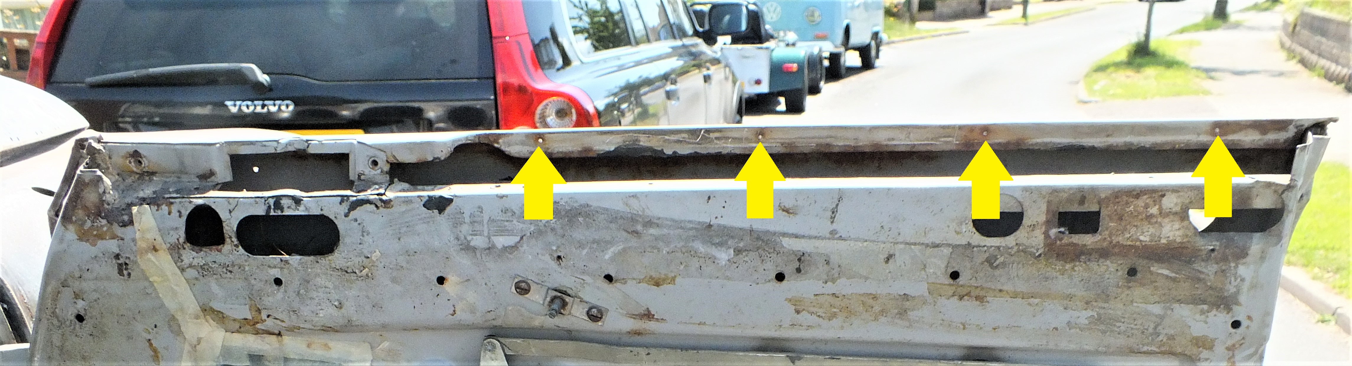

Next, what is the replacement process? Does the chrome bead, that it is fitted into, have to be fully removed? Or is there a way to insert the seal from the rear of the bead? If it has to be removed, what is the inner fastener (see photo 1) and how do you remove the 4 of them?
Finally, there is a metal piece, covered in felt(?), held to the inner door frame, on the inside of the glass. By four clips. What part no. is it and who supplies new ones?
Many thanks for your help and advice.

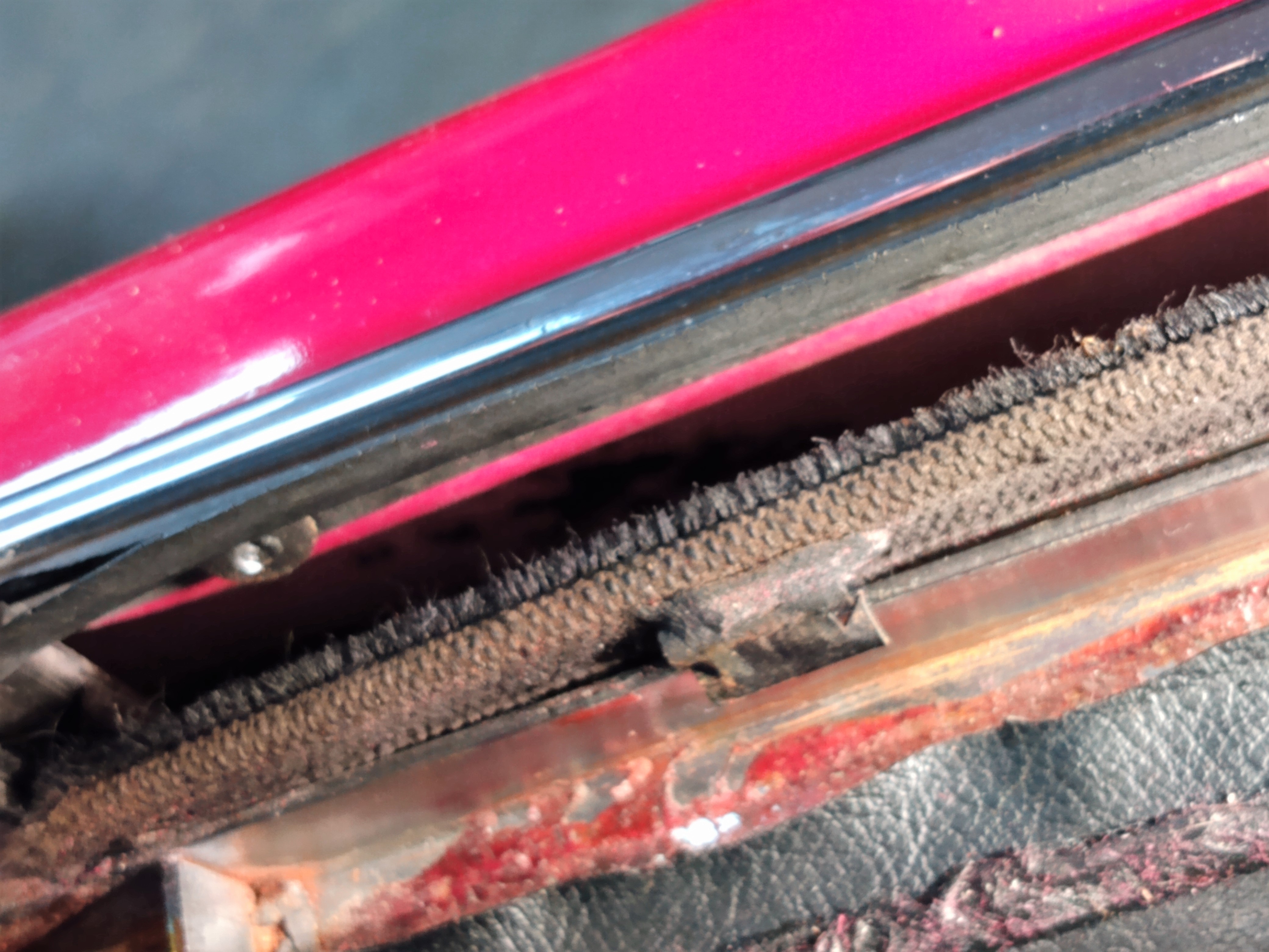

The inner felt section is held on to the inner lip of the door using metal clips. It comes in a long section with from memory a rubber backing and it is over this rubber backing that the metal clips are pushed. Here is a picture of the back of the clips when the door capping wood is removed. To remove and replace this section only the door wood capping needs to be removed and then the clips are pried off. Part number BD5195 and can be bought at SNG in lengths of 2 metres. https://www.sngbarratt.com/English/#/UK ... 0BD5195%60

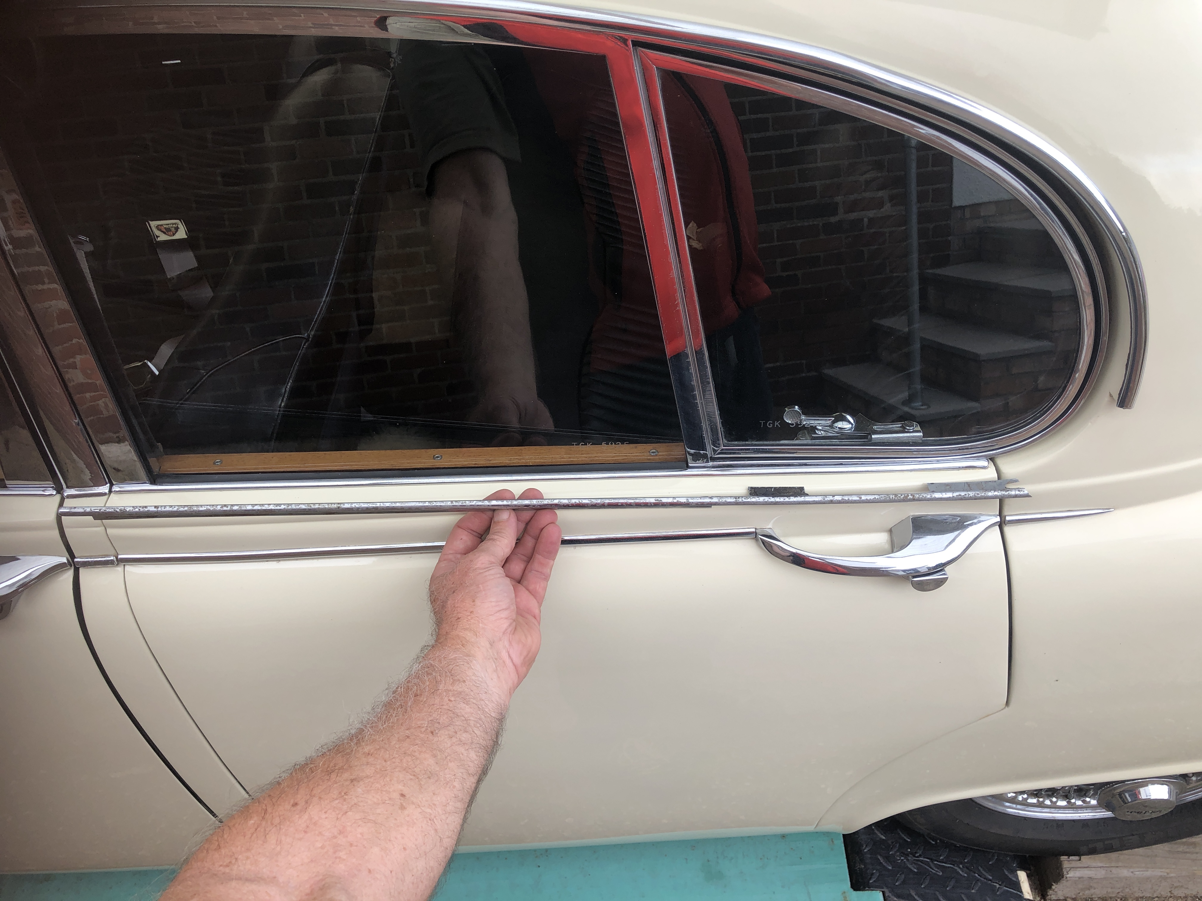

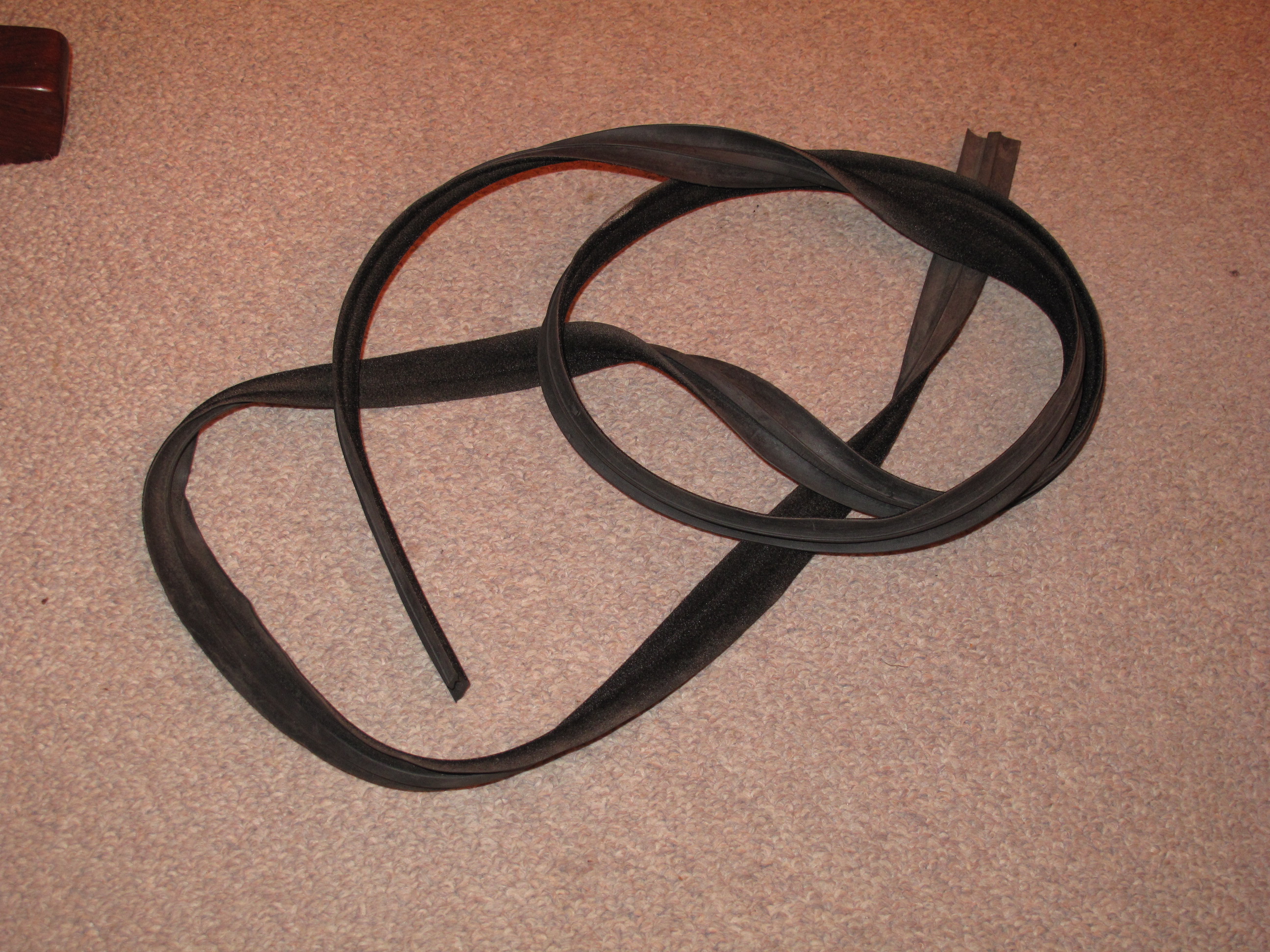

The outer rubber scraper section is a different kettle of fish. Again it comes in long sections of rubber like a windscreen wiper which you have to insert into the chrome which sits on the top of the door. Part number BD21073 https://www.sngbarratt.com/English/#/UK ... bd21073%60

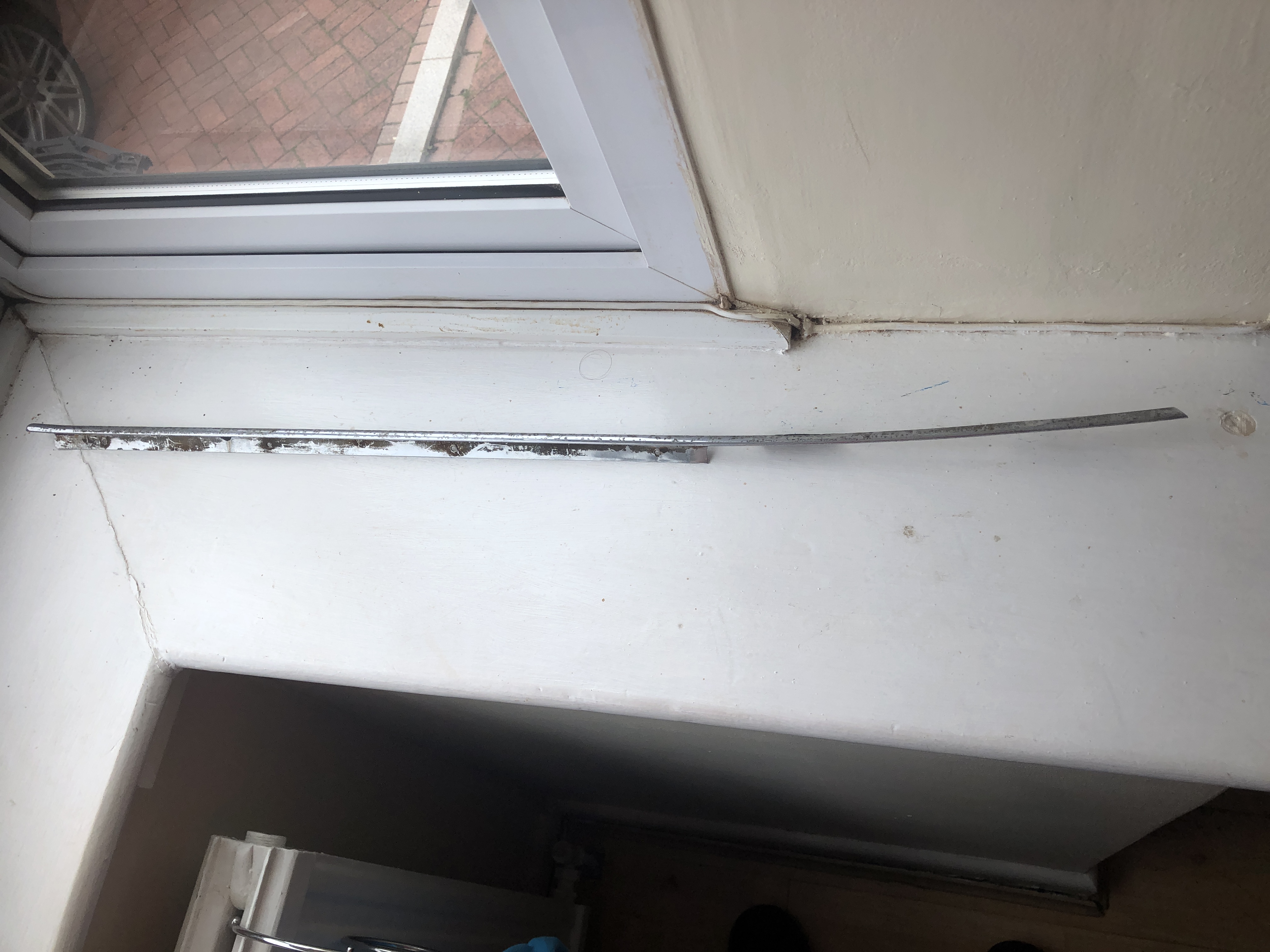

Problem is to get this chrome section off you have to strip the door right back removing not just the door cards but the window and chrome window surround. The glass has to be removed as it does not wind down far enough to get to the rivets. Attached is a picture of the chrome strip over the top of the door with my spare offered up.
My spare chrome strip.

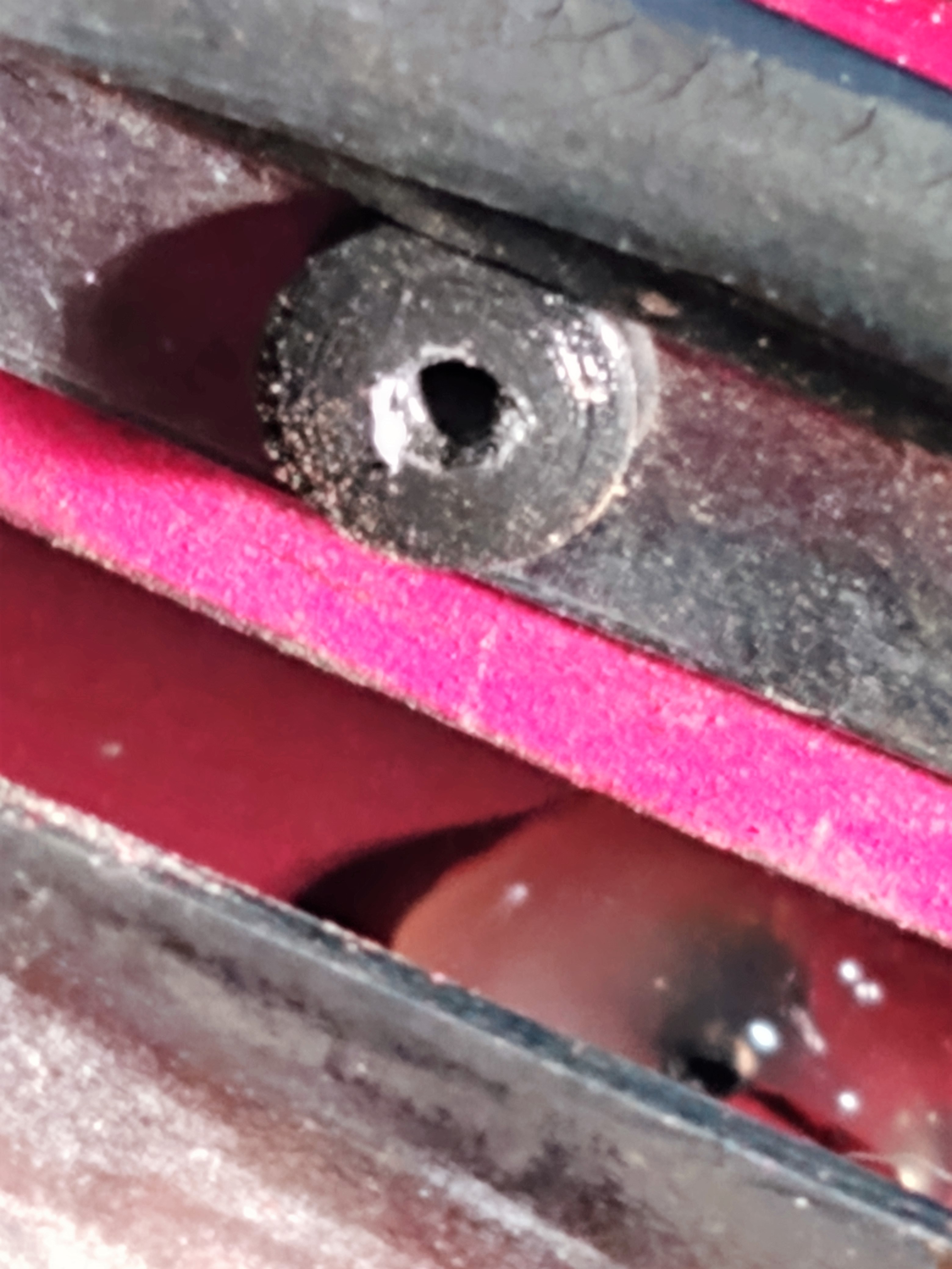

This is held in place by rivets which have to be drilled out and obviously replaced.
The rubber strip sits in the profile of the chrome.

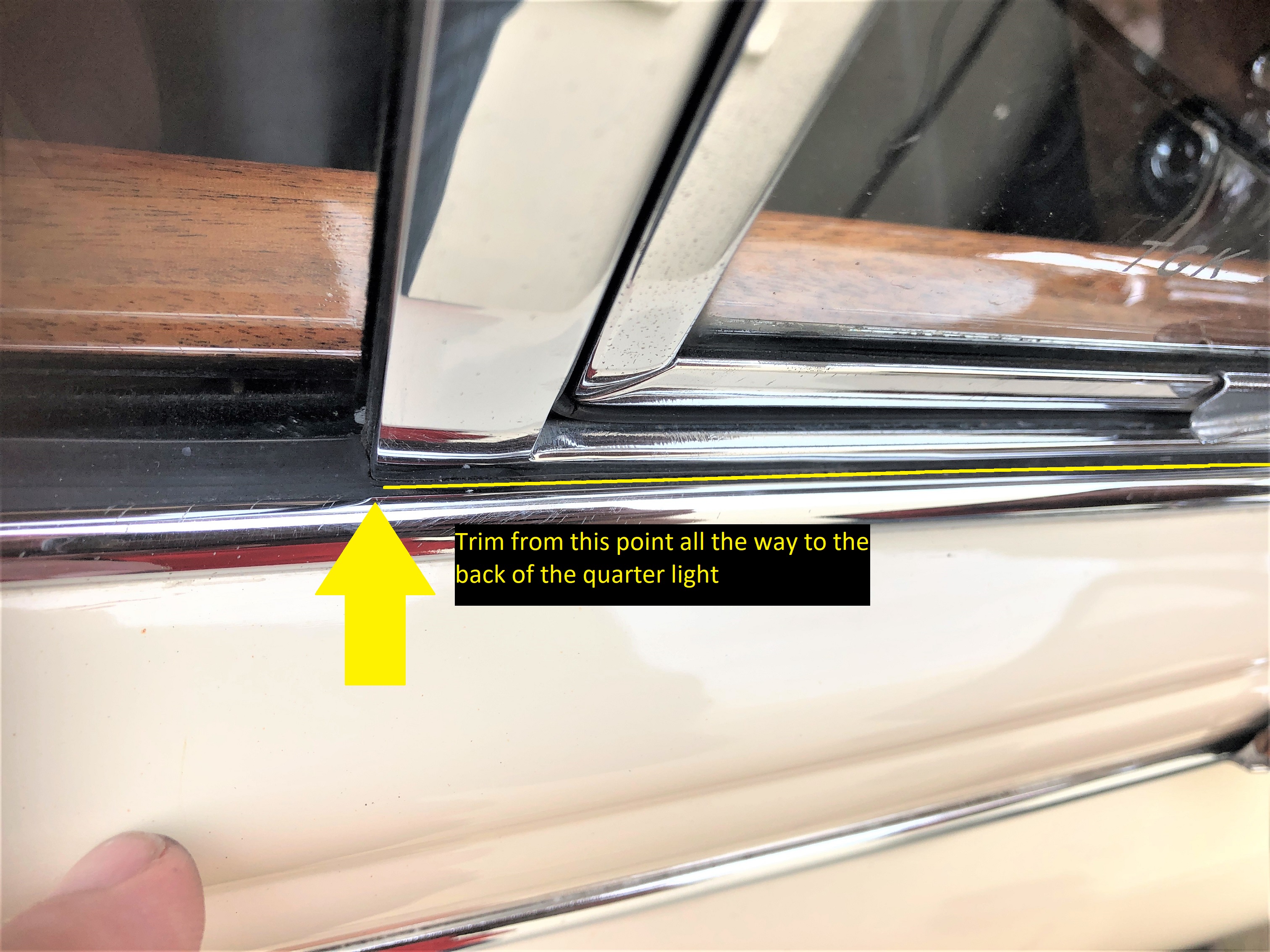

The rubber strip once inserted into the chrome has to be trimmed in situ as it runs along the bottom of the sliding window glass but also sits tight against the front rear quarter light and the door skin. This means you have to trim the top section off (The scraper bit) leaving the lower rubber section to make a seal between the quarter light and door skin. Hope this makes sense and I have attached some photos to try and show it but they do not come out very well.

Yes ~ the S type unlike the Mk2 has a whisker strip on the inside of the glass which comes in 4 precut pieces as it is not flexible and a rubber wiper that has to be pulled into a channel in the outer waist beading. The whisker strip is held on by stout clips. It is not felt (the Mk2 has whisker strip both inside & outside)
Tip. ~ after plenty of soapy water & pulling, pushing & kneading to get the rubber wiper strip into the exterior chrome channel. DO NOT trim to length for at least 10 days. You will have stretched the rubber & it will slowly shrink to size & be too short if trimmed immediately. A mistake we made & had to rectify.

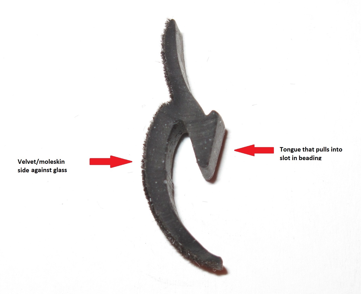

Outer door seal
Profile actually cut from my roll.
Whisker strip (metal edged). The deteriorated whisker strip can clearly be seen in David's 1st photo. The P/N I ordered under is dead. I'll try & find replacement.

Thanks Glyn I forgot to mention the stretched rubber bit before cutting. I feed mine into the groove and then bunched it up as much as I could so it was no longer stretched, Ie I pushed it into the groove rather than pulled it, but still waited until it had settled down before I cut it to length. I would also clean out the groove the rubber strip has to go into with some wire wool to get it clean then lots of soapy water to slide the rubber in to the groove.

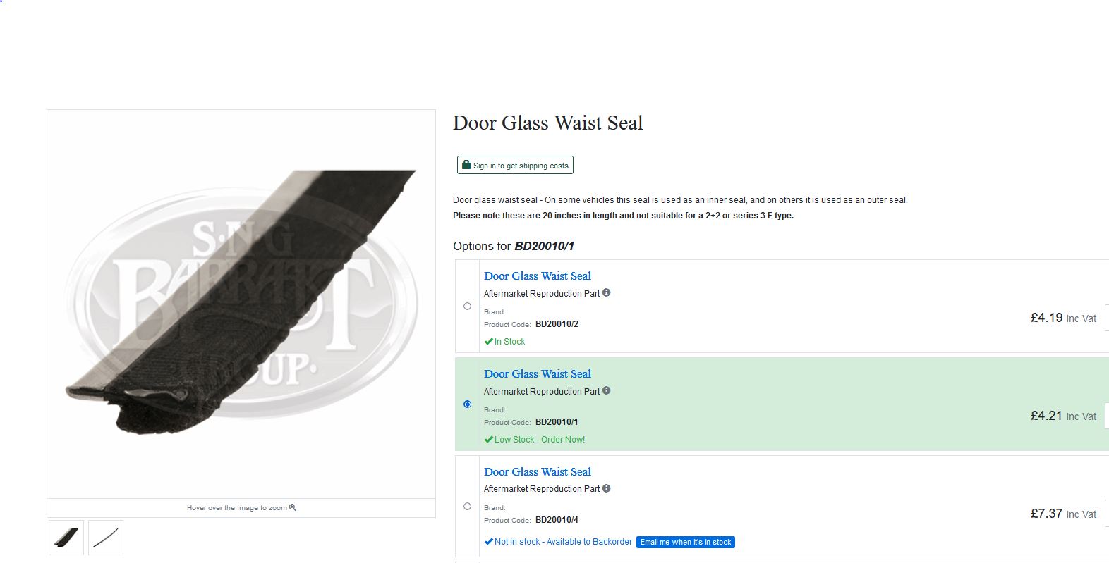

Here is the correct inner whisker strip. Will need trimming to length from 20". The old precut & correct sets of 4 seem no longer available. Only order as BD20010/1
Re: Side Window Scraper
That is the one I used Glyn. It has a metal edge into which the brush is fixed and it is this metal edge which goes under the metal clips not as I thought at first a rubber strip. Easy to cut to length using tin snips or wire cutters.

Part Number for Whisker Strip. Only use this number as there are some strange substitutes.
BD20010/1
Because it was used on many cars it is yet another omission from the S type Parts Manual ~ "Door glass waist seal - On some vehicles this seal is used as an inner seal, and on others it is used as an outer seal." The only place you will find it listed is in the Mk2 Parts Manual as an outer door seal. The Mk2 used this whisker strip as an inner & outer seal pre the neoprene wiper as fitted to the S type. The number above is the original P/N ~ The quality of my inner seals from Barratts was excellent so I would have no fears as long as you order under the above number. I was running the S type filter on the Barratts site which is why I could not find the P/N that I ordered under which is as above. That is why the number was "dead"
