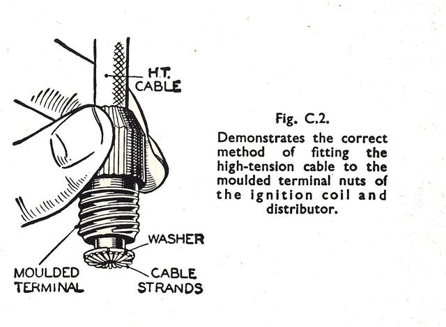

I'm trying to deal with a 2 or 3 fold problem. One is that the wires pull out of the cap very easily making me wonder if they Ever make a good contact. This thought is compounded by (two) a high speed low load miss which feels a lot like hitting a pothole. And 3, some of the wires have brass contact plates at the dist. end and others have small screws directly into the end of the wire. I suppose either way could be sufficient, but the whole thing just seems so .... tenuous. I do not have the conduit to thread the wires through. It's the contacts in the cap that I don't trust.

This is the genuine Jaguar HT lead set I have fitted to my car but fitted with Champion bowtie plug caps which screw into the leads. Supplied with the set.
This is the correct termination for the leads with Acorn nuts & split brass washers. I have no issues at all.

Ah! I see the washer with the strands. That seems much more secure as the nut would then have something to hold. Since mine do not, I have put a wrap of electrical tape around the end of the wire to increase its circumference. This only "sort of" works.
Re: distributor cap swap
Yes. The split washer acts as a slight spring washer & keeps everything tight.
