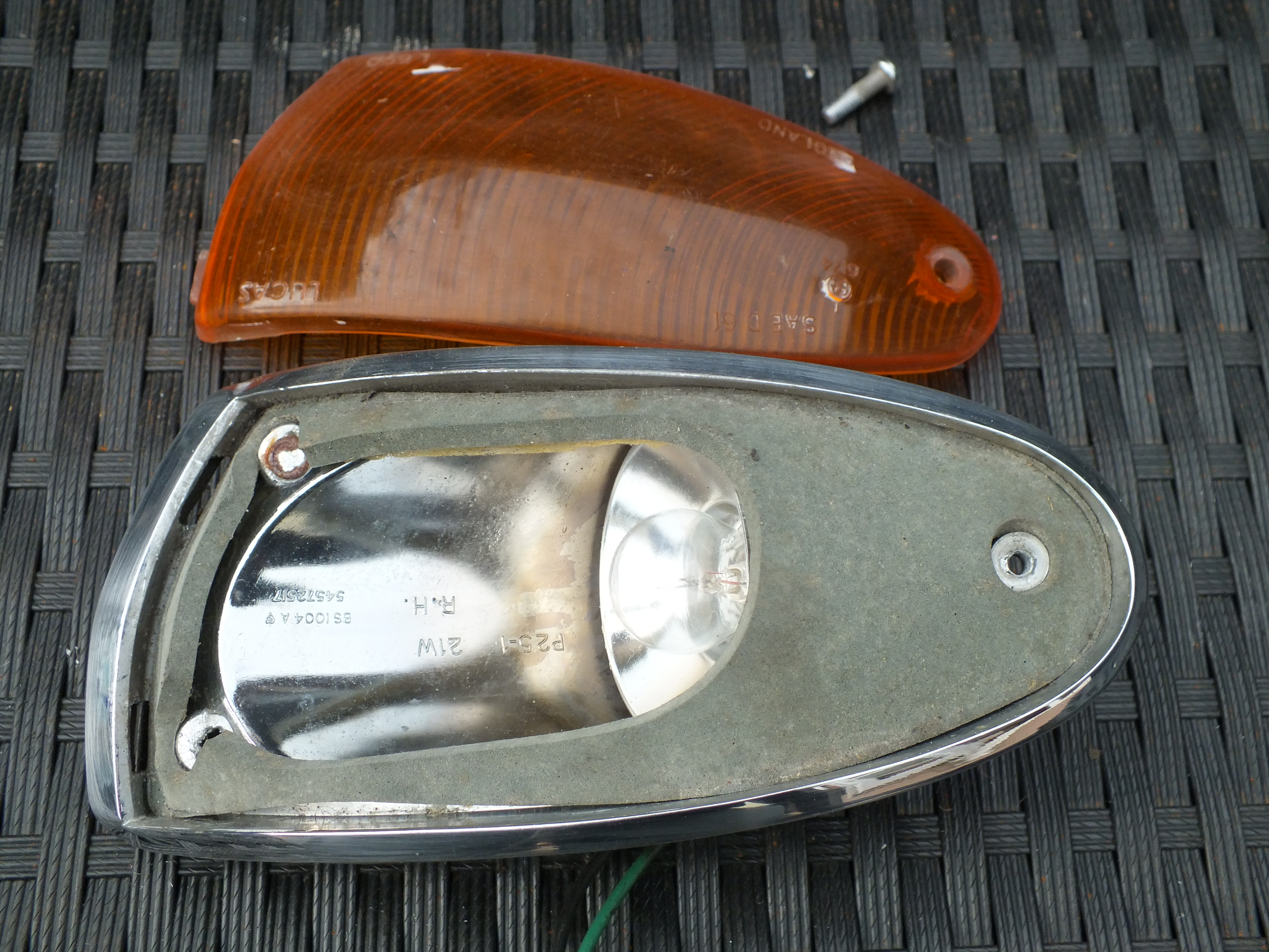

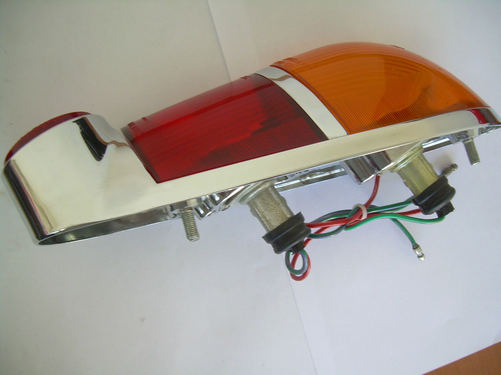

If you are talking about the front indicators. The indicator housings and lenses are sided so should only go in one way. Inside the housing there are letters which tell you which side it is. For instance this lens is for the right hand side as you can see below the 21w sign it has the letters RH.

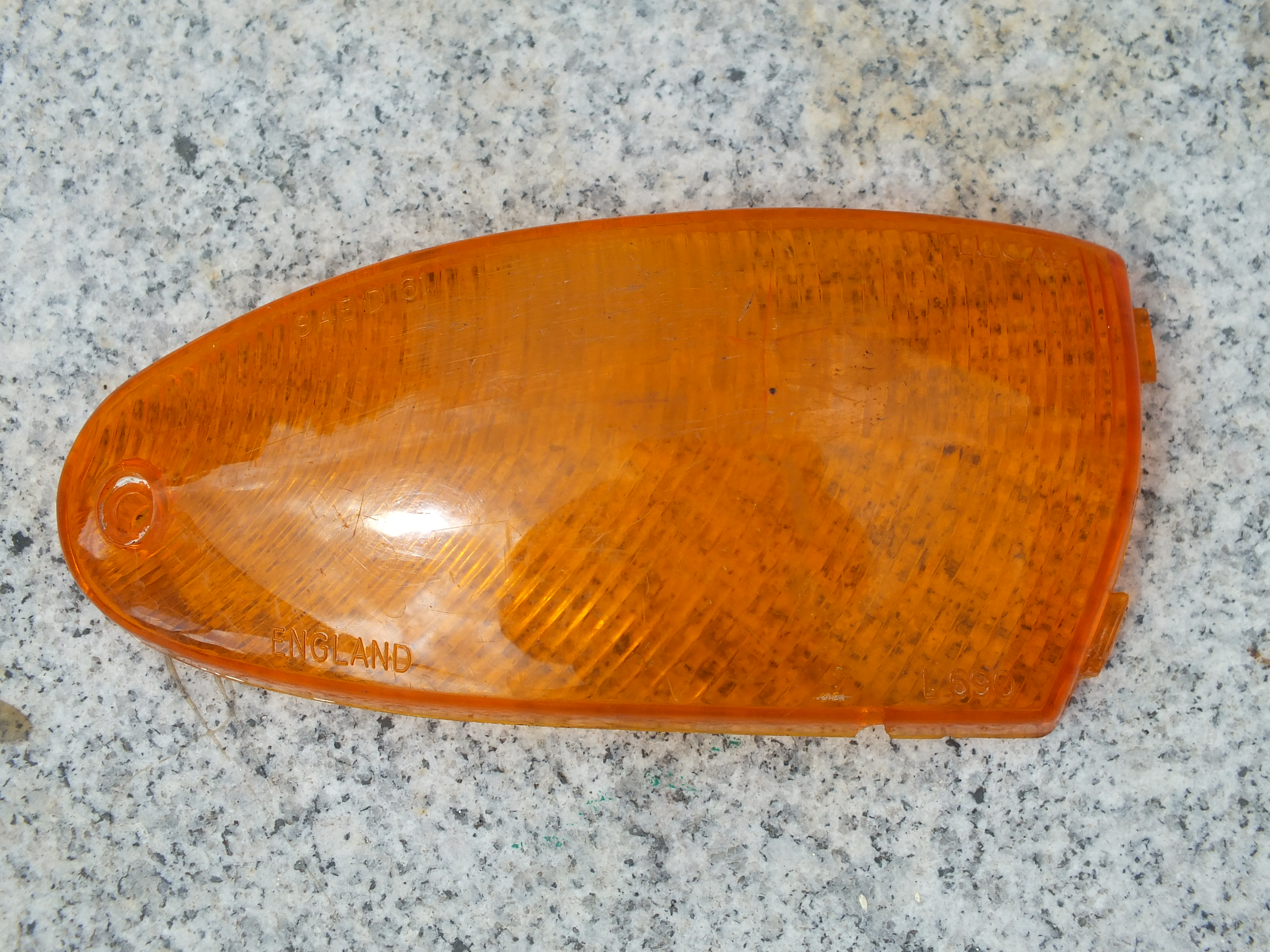

The top of the lens is curved and there is on mine the words "L690" in one corner and "ENGLAND" in the opposite corner near the screw hole which would need to be facing the correct way up.
Below are photos of the left and right lenses.
The clear lens which was for exported cars has the same "ENGLAND" in the corner.

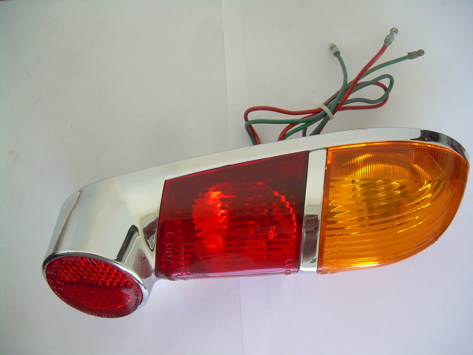

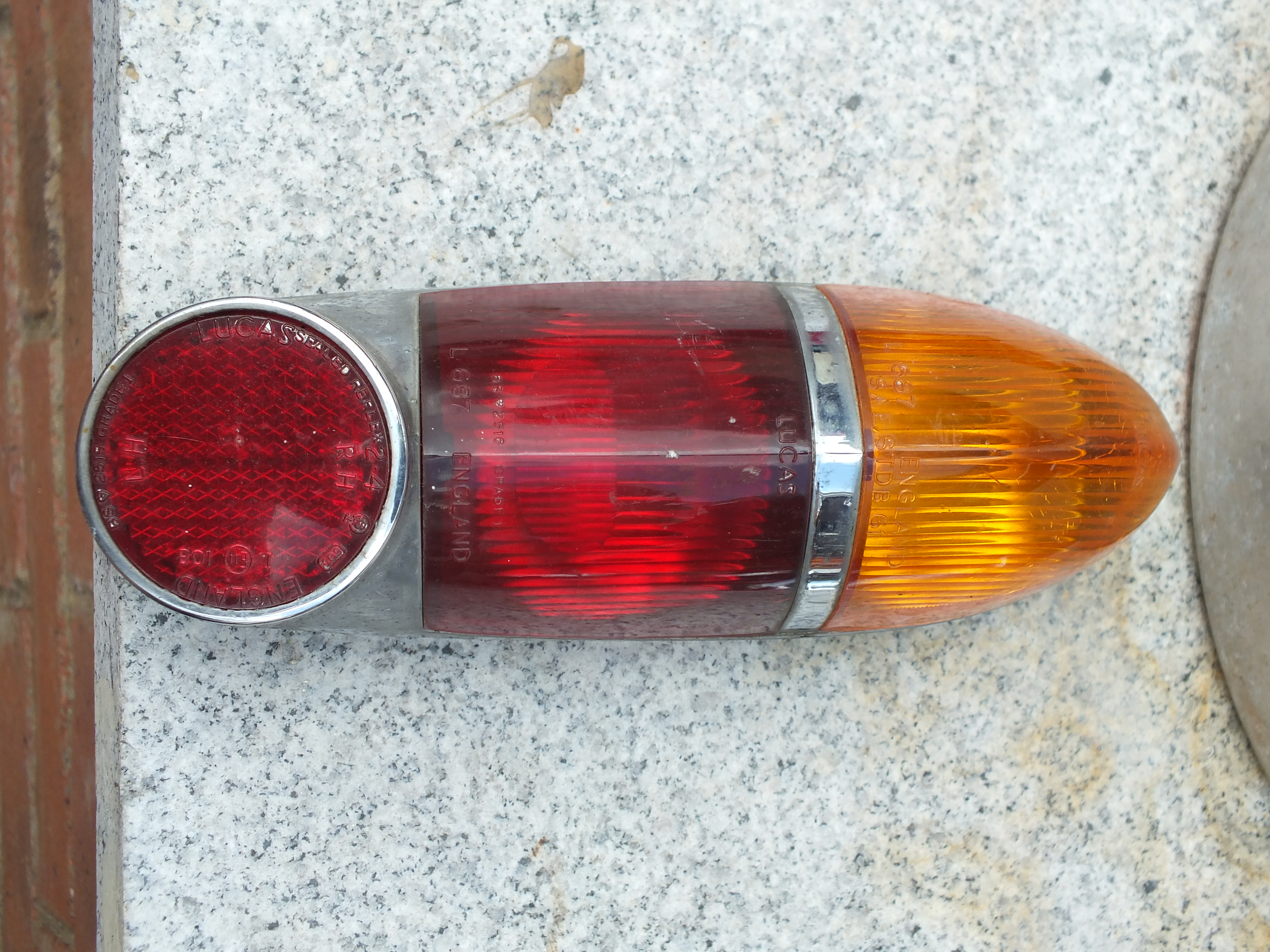

If you are referring to the rear light clusters than they can be put in either side and it is only the lower red reflector lens which is sided. The lower reflector lens can be removed and turned upside down. The lens is slightly thicker on one side that the other so it sits in the aperture at an angle so the light is reflected in the correct direction. On the lens there are the letters "LH" and "RH" so you orientate the lens so the "RH" is readable the correct way up for the right side and vise versa for the left side. This rear cluster is set for the right hand side.

Sorry to bicker but the chrome bases of the rear lights are also sided as the chrome reflectors in each unit left to right are differently angled.
LH Base is P/N 9356
RH Base is P/N 9357

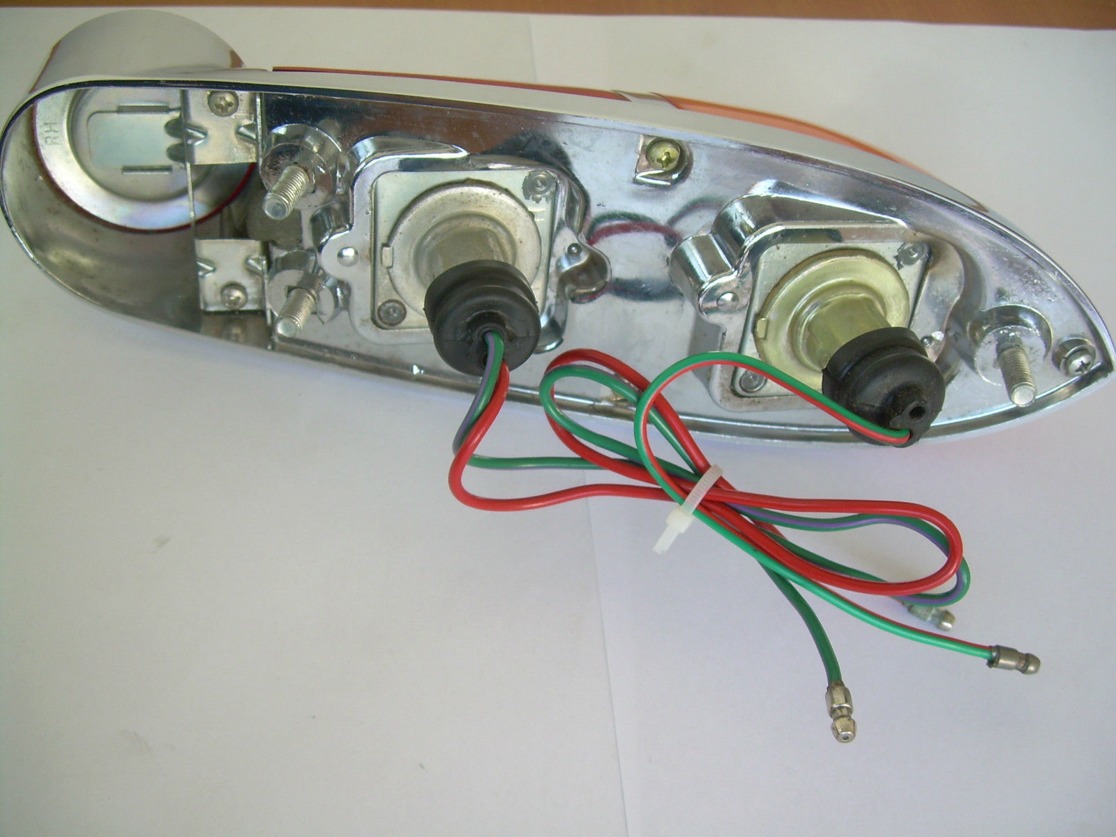

You are right Glyn two different part numbers which I had not noticed so I pulled out two of my spares to see what the difference was between them.
The chrome surround on both left and right is identical so the clusters will fit the body work either side you fit them. There are no markings on either to indicate that one is right hand and the other left.
The reflector insert can be swapped to left or right in both.
The difference between them is the inserts for the brake and indicator bulbs.
You can see in these photos which show the left and right clusters that the bulb holders are riveted in at different angles to allow the bulbs to point in the correct directions. The right side cluster is on the right as you look at my photo and the left side cluster is on the left. It is difficult to make out in your photo which side that cluster should go.
Presumably they are swapped over for an exported car that drives on the right. I am also assuming because I have not seen them in person that on the SNG reproductions the bulb holders are possibly riveted in flat so they can be used on either side and any country.

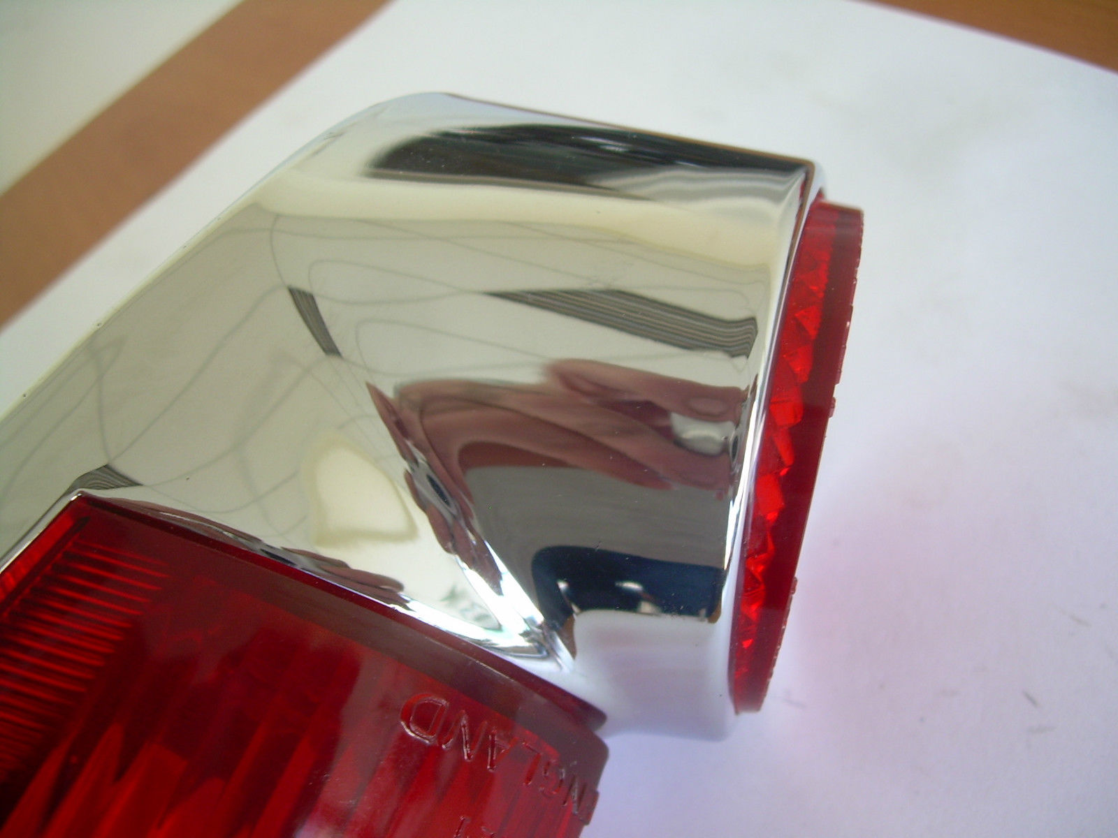

The pics above are not actually my set but rather from the internet many years back. They show the angled bottom reflector well.
