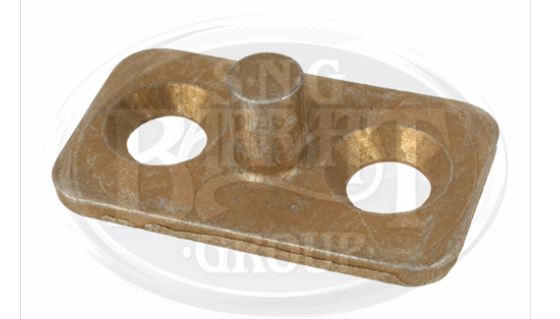

Some of you may recall that a while back I had a problem with not being able to get my boot open. With your collective assistance that problem was solved. Now, for some unknown reason it shuts but won't stay closed. No, I am not making this up. It has worked just fine for months now and I use it quite a bit because I use it to store stuff. Can anybody offer any clue as to what is going on? It shuts with the usual click, but then just spontaneously pops open????

Thanks. To clarify, by "catches" are you referring to the posts inside the lip at the bottom or the parts that swivel on the boot lid itself?
Re: Boot won't stay closed
The posts Rolley.
Just loosen them up so you cannot move them by hand but they will move with the heavy boot being pressed firmly against them. Move the posts up a little before you do it so when the boot is closed it pushes the post down as they engage.
Then firmly holding the boot down (you might require an extra pair of hands to hold the boot lid down as you press the button) depress the boot release and allow the boot to rise hopefully not disturbing the position of the posts as it does so.
Once the boot is open tighten the posts up and try the boot for fitting and for the catches to lock on to the posts.
Its a bit fiddly but the only way really to set the position of the posts in relation to the catches.

The boot lid now closes and stays closed as it should. It just needed some lubrication and working the latches a few times. And having taken it apart I now know how it works. Thanks for you help gentlemen.
