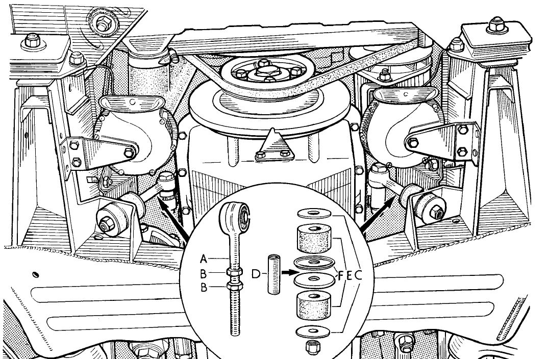

Parts Manual shows to front. So who knows? If in doubt maybe the way to go.

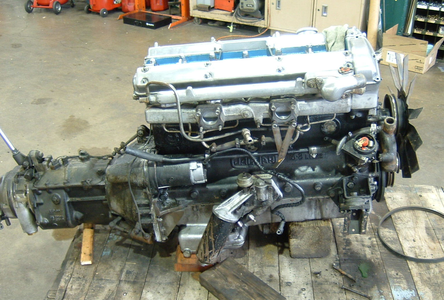

Glad my LH and RH side engine photographs are finding their way around the internet and assisting others in reassembly work. By the way, my recently overhauled engine is back in the car and the shop is doing the final 100 mile road test before I can finally get it back and drive it myself. It's been a long process. Keeping my fingers crossed there are no glitches.

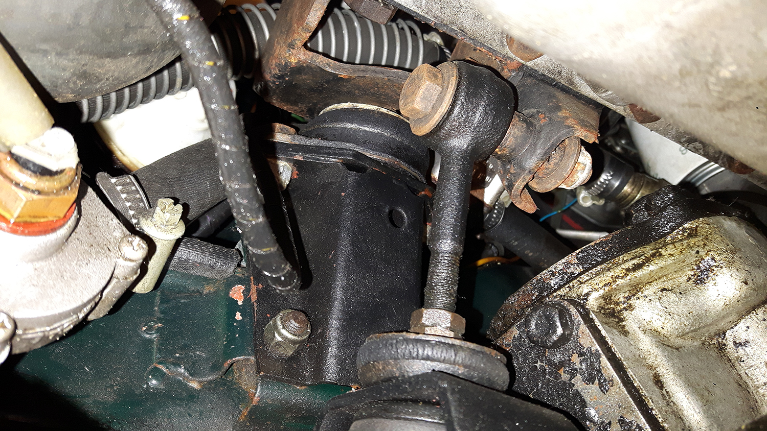

Hi chaps, further to Rob's call last night I have posted here my car with the mount hole towards the rear. It looks like i have removed them sometime in the distant past for painting, i just hope they went back in the correct orientation so take this with a pinch of salt.

Same orientation as Glyn and myself Nigel but all three of us have removed the brackets in the past and we are not sure we have replaced them on the correct sides. Such an easy thing to do when they are sided but not marked and the difference between the two sides is minimal.
