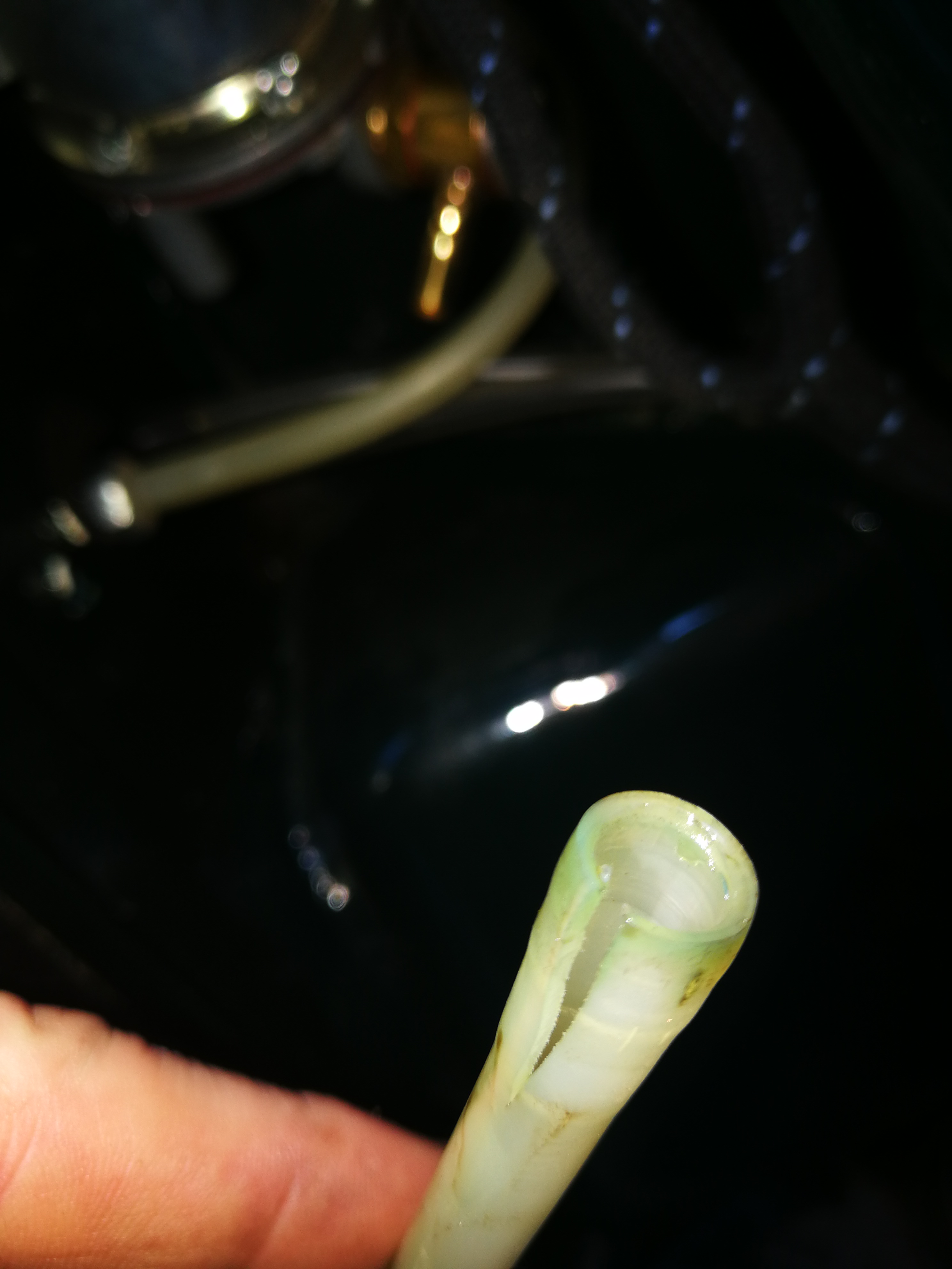

The Hardy pumps are compatible with all alcohol fuels. One thing I checked on as in SA's Highveld area we have 12% Sasol heavy alcohol in our fuel which wiped out my correct look nylon fuel piping in a couple of weeks so I went to black alcohol compatible flexible piping.

Jaguar nylon fuel hose after 2 weeks exposure to SA alcohol laced fuel below. All elastomers, nylons, plastics in the system need to be alcohol compatible. The alcohol containing fuel needs to be kept dry to prevent phase separation & corrosion issues. Alloys in fuel system components need to be free of even small amounts of yellow metals (e.g. Copper) or this catalyses corrosion. Terne coat plated steel fuel tanks can give trouble.
