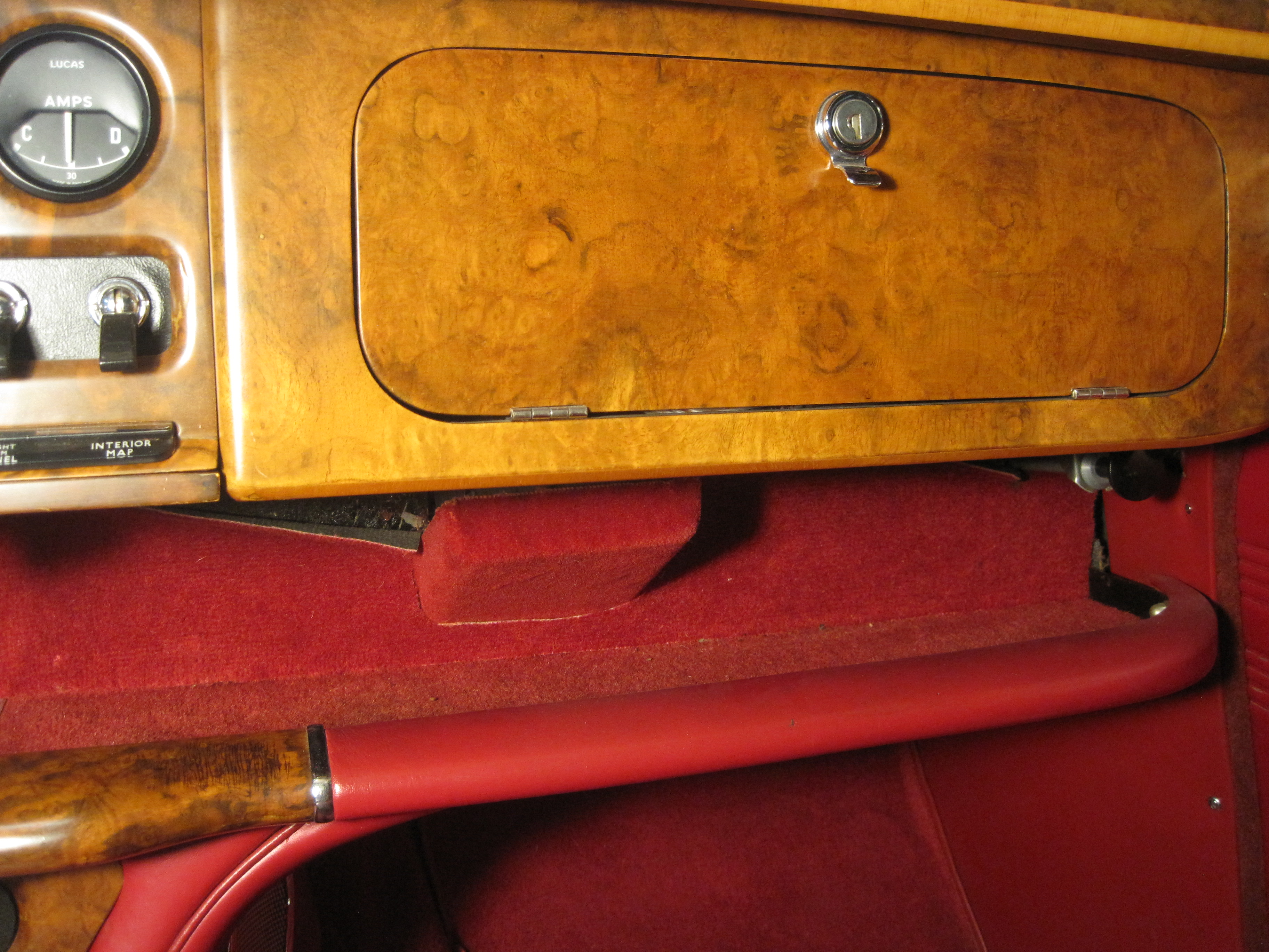

Beautiful, Joe.
Wonderful!
Looks fabulous! Really nice job of finishing. Forty three years ago, not knowing any better, and being very familiar with how satin polyurethane worked, I restored my wood in satin. It looks nice but is much better, and more original, in gloss. Maybe I'll redo it in my next life.

Looks really good Joe. Interesting radio that, what is it?
NigelW wrote: Thu May 09, 2019 4:18 pm Looks really good Joe. Interesting radio that, what is it?
Looks like a Retro Sound.
Posts: 527
Got some serious knobs on!
Very Nice Joe. Not envious at all!
Thanks everyone. Yes, the radio is from Retro Sound. It is a Motor 1A model. The wood oval shows ever so little on each side when looking at an angle, but I can live with it. All the modern features and the retro look. Starting the doors on Sat.

I see you have gone for the polished brass top on the radiator Joe. Good choice.
Question though, you have got the radiator in but I see no fan attached nor radiator cowling and I recall from fitting mine that the fan and cowling have to go in before the radiator. There is no room to do the nuts up on the fan and no room to get the cowling between the fan and the radiator. Very tight fit.
Also when you do have the fan on and are lowing the radiator into position make sure you have a piece of cardboard protecting the back of the radiator or else the fan blades will damage the fins on the radiator.
