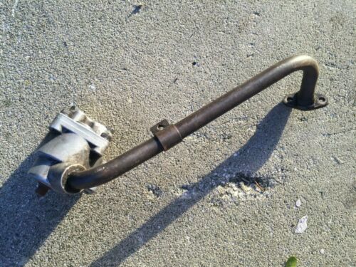

So I went back to the parts list.
Oil suction pipe from oil pump to sump is part number C21762 and is the same on both the XJ6 and S type. SNG Barrett stock this for the S Type and XJ6.
Oil delivery pipe from pump to engine block on the S Type is C21846 but there is a different part number for the XJ6 which is C22595. SNG have C22595 for the XJ6 but do not have C21846 for the S Type. I am assuming having two part numbers is possibly more to with the shape of the pipe fitting between the pipe and engine block than the diameter of the pipe but I might be mistaken.
C21846 for the 3.8 and 3.4 S Type has a fitting to the block with just two bolt holes. https://www.ebay.co.uk/itm/Jaguar-Oil-P ... 3779205178
Oil Pipe C21846.jpg (59.37 KiB) Viewed 3156 times
Where as C22595 for the 4.2 XJ6 has a three bolt fitting to the block. https://www.sngbarratt.com/English/#/UK ... 0C22595%60
Oil pipe C22595.png (41.14 KiB) Viewed 3156 times

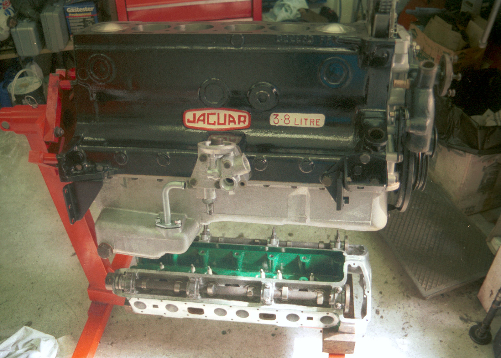

This is a photo I took of my Engine 8 years ago when I stripped it down before the rebuild. You can clearly see the two bolt hole fitting at the bottom of the picture where the pipe fits the block. The engine is a 7B block from a 1967 3.4 S Type.
Hard to see how the XJ6 pipe with the three bolt fitting could fit the S type block but as you say Nigel Jaguar changed so much in the early years and in 1966 that anything could go. You pulled your engine quite recently did you not take photos of the stripdown?

Re: Engine Oil
I've been back through the photos i have of the engine build and unfortunately I didn't take many, probably due to pre digital camera era as it was 1998 - I did say it was a while back and haven't got any shots of the crank etc. You are right about the block and pipe and the number of bolts, it definitely had two bolts. The only thing I can think of with regard to fitting larger bore pipes is that my block was built to Mk2 spec but it was the original engine (matching numbers) confirmed with heritage certificate but definitely had to fit biger diameter pipes.
