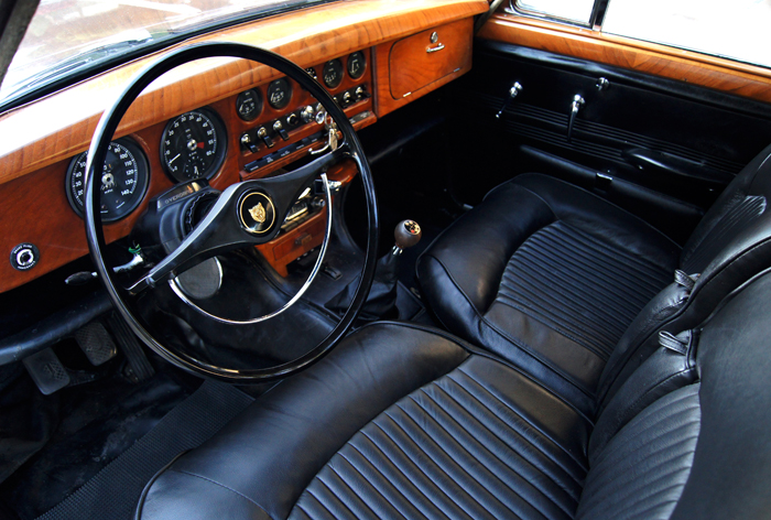

Here is a 1966 Left Hooker from Browns Lane with woodwork similar to mine.

Having a good look through my "Interior Reference" file Jaguar's veneering was extremely variable.

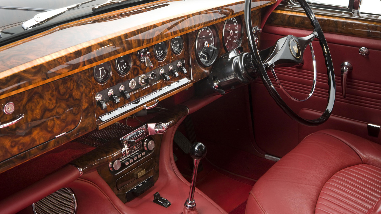

I think the original Press Demonstrators were very carefully selected. (one of very few photographs I've seen of a car without a bent horn ring)
A very good total re-veneer: Browns Lane seldom if ever achieved this.

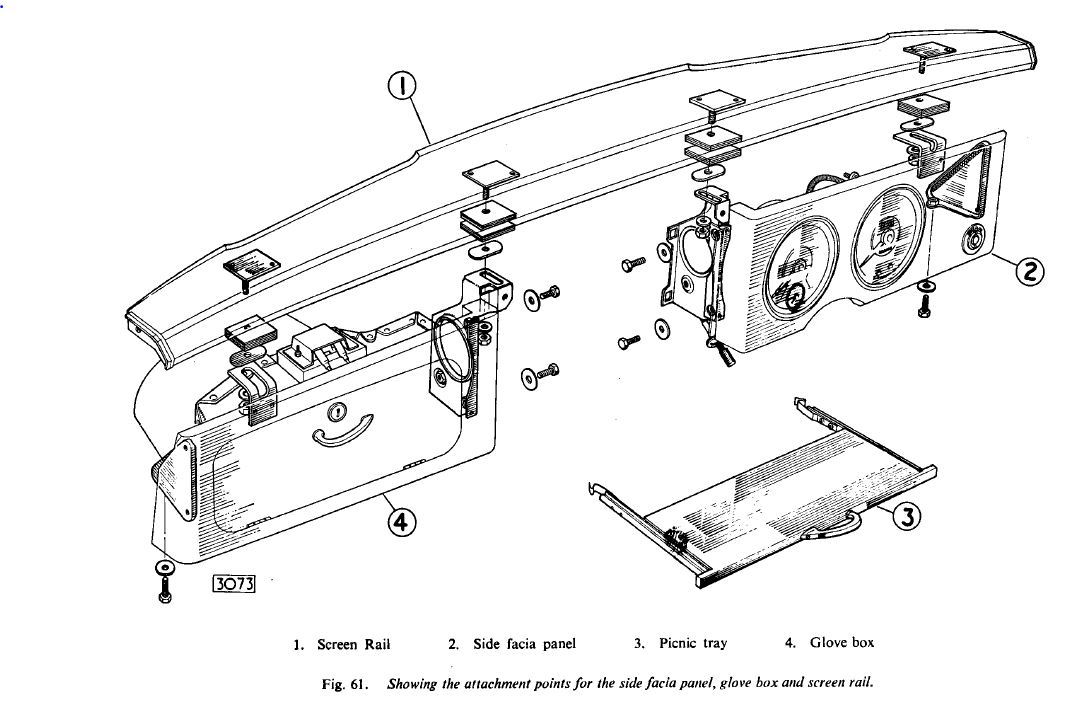

Orientation of pull handles on the tray and glove box lid
As this has been queried elsewhere here I thought I should clarify on my own thread.
Glove Box lid & Tray handles are correctly fitted in opposing orientation on RHD cars & aligned orientation on LHD cars.
In RHD cars the glove box & tray handles are mounted in opposing orientation like this.
Dash Attachment.JPG (117.43 KiB) Viewed 5171 times
In LHD cars the glove box & tray handles are mounted in the same orientation.
http://www.jagstyperegister.com/forum_n ... 1439#p1439
http://www.jagstyperegister.com/forum_n ... 1633#p1633
