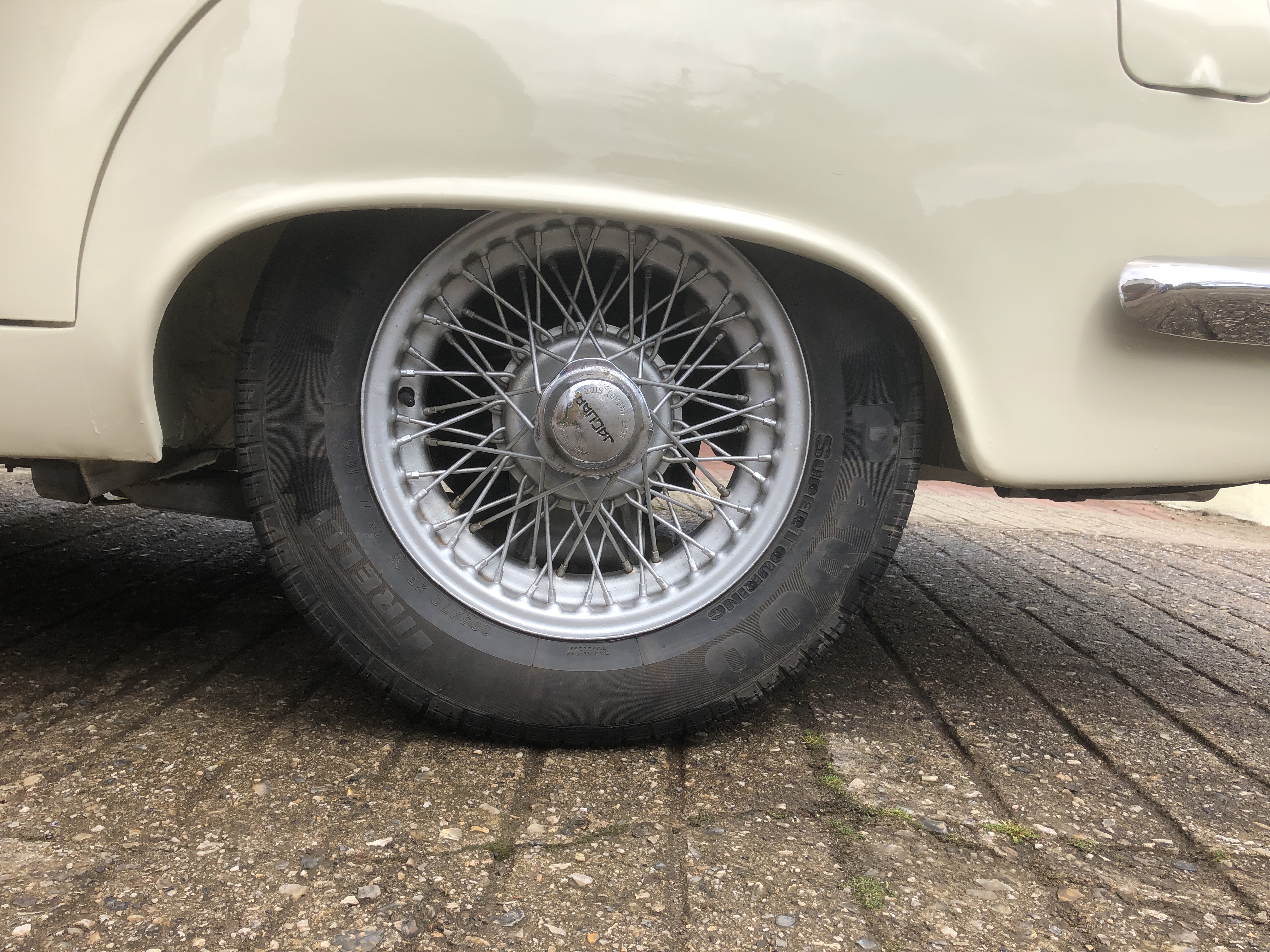

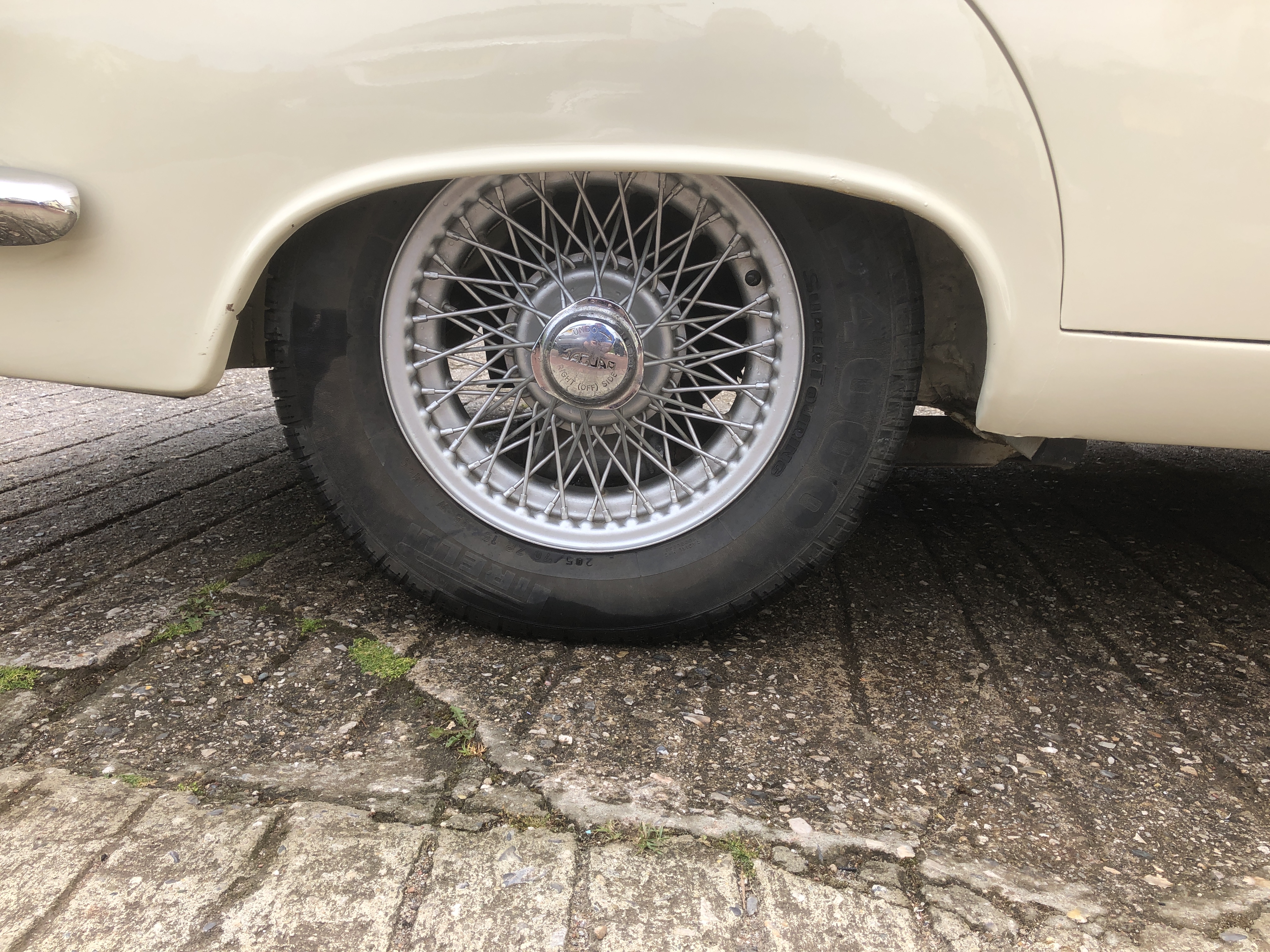

Part of my purchase of lots of boxes of spares there came four brand new rear shocks with springs and two brand new in their boxes front shocks. I have already changed the front springs so this week was out with the old in with the new.
Easy job as you do not need to compress anything and my nuts and bolts having only been on the car for four years came off with no problems. With all the bolts undone it is a very easy job just to switch out the old and put in the new, regrease the bolts and it was finished in four hours.
Although I thought there was nothing wrong with my suspension I immediately felt a tighter rear end. Not so bouncy over the bumps and less wollowy driving down the lanes.
Ride height at the front has not changed as this is governed by the springs which I did not touch but the back end has dropped down almost an inch which now makes the car sit parallel to the ground whereas I used to have a slight front end dip. The distance between the rear arch and the wire is now roughly the same as Nigel's and Orlando's.
Very happy.
Very happy.
