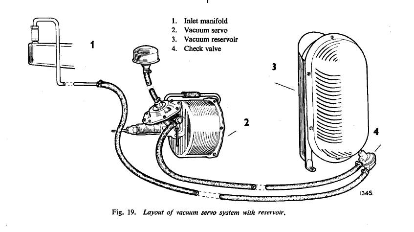

Early type servo shown in diagrams but connections the same:
Brake Vacuum System.PNG (47.79 KiB) Viewed 3774 times
Brake Servo connections.PNG (44.57 KiB) Viewed 3774 times

Glyn,
Diagrams help a lot. We think we have it figured out.
