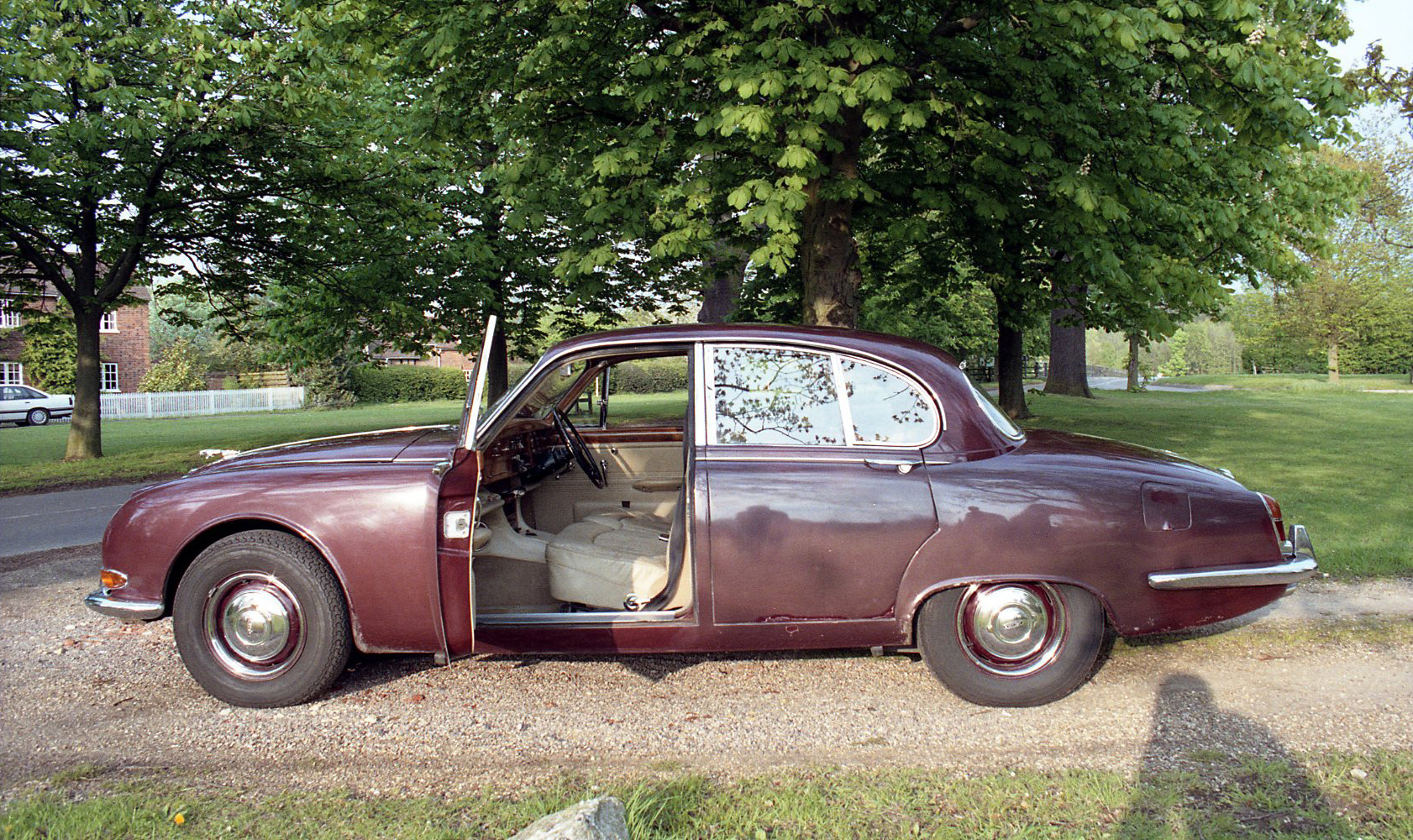

Oh, and this was my car on its original springs in 1992. The moral of this photo is that you don't need to replace them, as I found out to my considerable time and cost!
Re: Suspension misalignment
Wow they are a lot lower at the back and I notice that the sills are parallel to the ground where as mine is slightly nose down!
I can see I am going to have to get the angle grinder on the rear springs.lol.
Having said that as a joke there is no adjustment in the rear ride height. The shocks and springs are a set height. I know two rear shocks and springs were changed about 17 years ago on the 14th of November 2001 ( the car has only done 5000 miles on them since). I put all new bushes in but then the photos you have shown here would have new bushes. You would expect an older car to sag a little but these are very low.

Your car looks pretty much spot on in that pic Orlando. Alas some cars have not fared as well. I've seen some real low riders both back & front.Orlando St.R wrote: ↑Mon May 06, 2019 2:53 pm Oh, and this was my car on its original springs in 1992. The moral of this photo is that you don't need to replace them, as I found out to my considerable time and cost!
Yes, fair point. Though they may not be on their original springs, of course.
My car was on about 70,000 miles, in the 1992 pic.

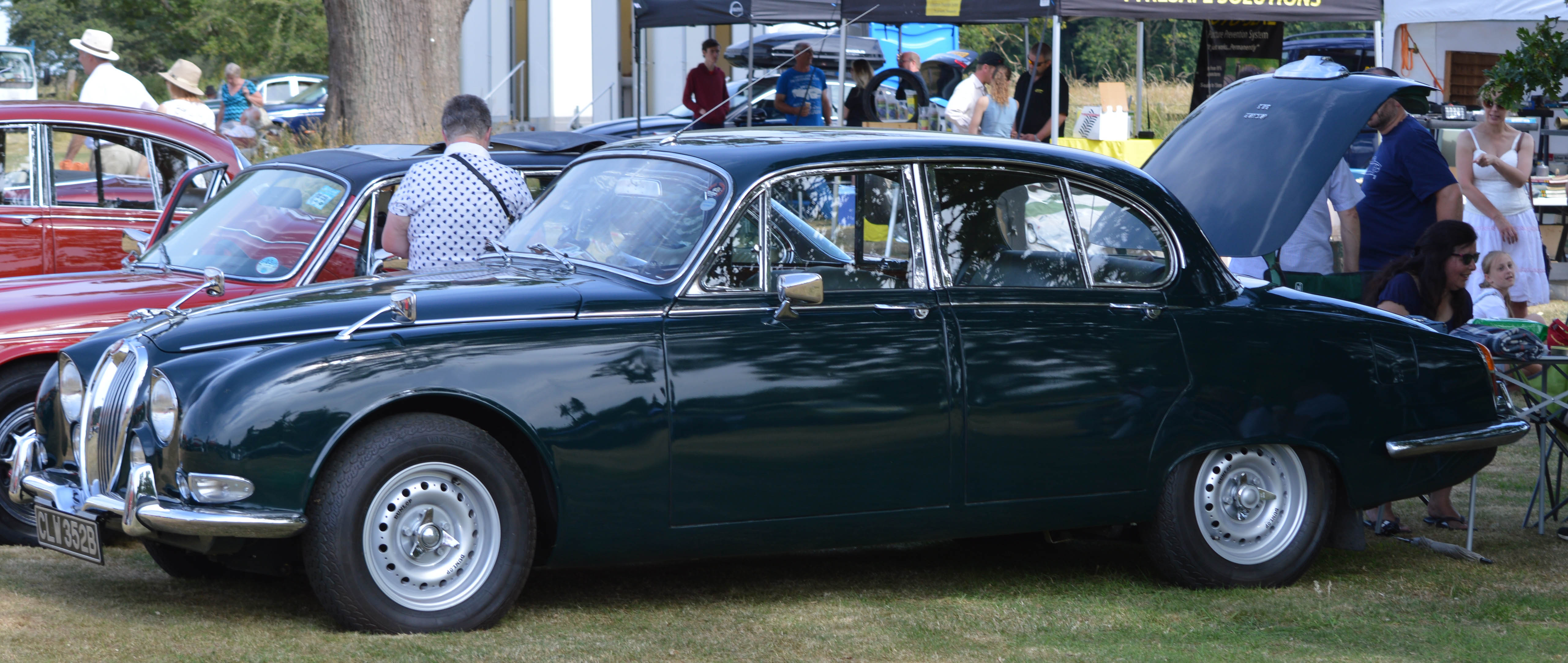

This is how my car sits with Watjag springs front and back.

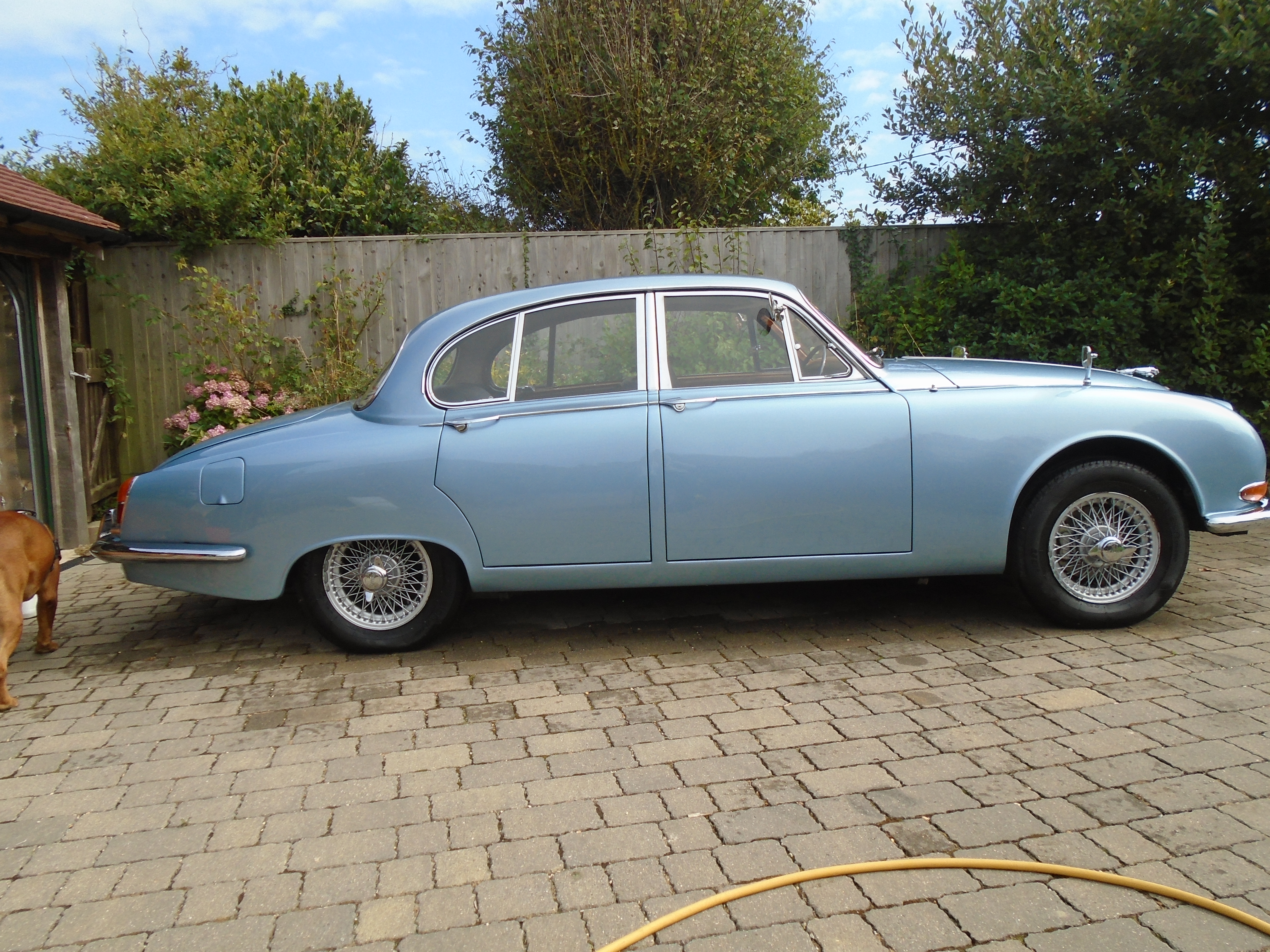

Just thought that I would add a picture of my baby, not long after she had new springs and poly bushes, you will see that she is quite high on the front , to me the back still looks a bit low
john
john
Your car looks beautiful, John. Really lovely in that colour.
I agree it looks a touch high at the front, which may well settle.
