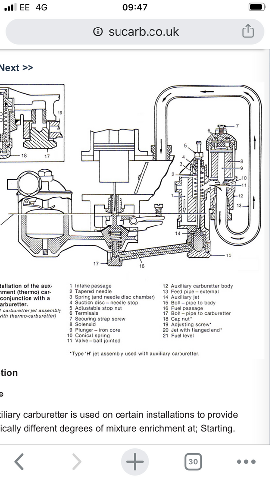

This cut out view of the Carbs was posted on another site so I thought I would bring it over to here. It shows clearly the fuel levels across the floats, needle valve main jet and the AED.

Hey Cass,
Something is wrong with this cross section. I can see the point that the fuel level is the same level in all three components, but this diagram shows the fuel level in the jet WAY down in the jet. I think the relative heights of the float chamber and the carb body are drawn incorrectly because with the float height set correctly, the fuel level should be near the top of the jet. Anyway, I still haven't had a chance to fire up the old 'S' since rebuilding the carbs. More news later.
