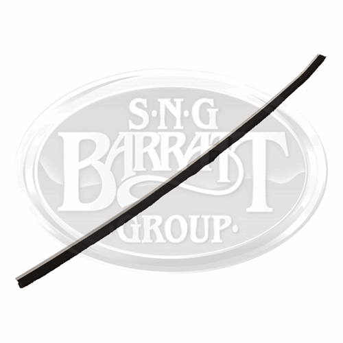

Yes you need 4 Joe. One for each door's winding window. (to fit in each doors external chrome waist trim 32,33,35,36.)
You will also need 4 internal "Whisker" strips (Door Glass Waist Seal internal for S Type) that are held to the inside of the chrome window frames by clips & the winding windows buff against on the horizontal inside of the door.
I bought 4 X BD20010/1 and cut to length because they are not finished length anyway.
or you can buy 2 X BD20010/1 & 2 X BD20010/2 ~ same stuff just different lengths.

Got it....that part was included in their rubber kit which I have.
Thanks so much....you are a wealth of knowledge.

Interesting! It's one thing I've never seen in a rubber kit. No rubber in the part.
