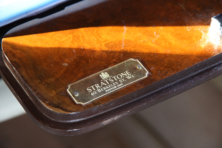

I always liked this rather nice touch on the inside of the glovebox lid. Wonder if it'll come off in one piece when I eventually get around to having the woodwork done. Another excuse to put it off. :)

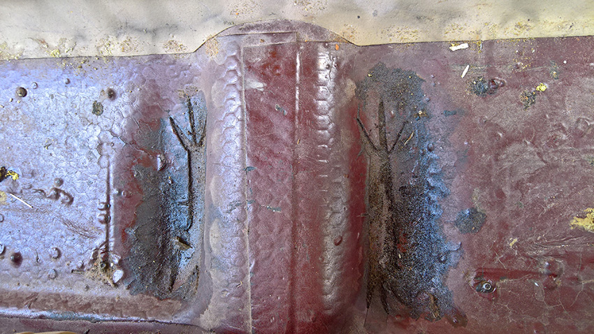

Has anyone seen holes like these beneath the rear seat? Presumably it must have been for access to the cross-member/rear brakes.

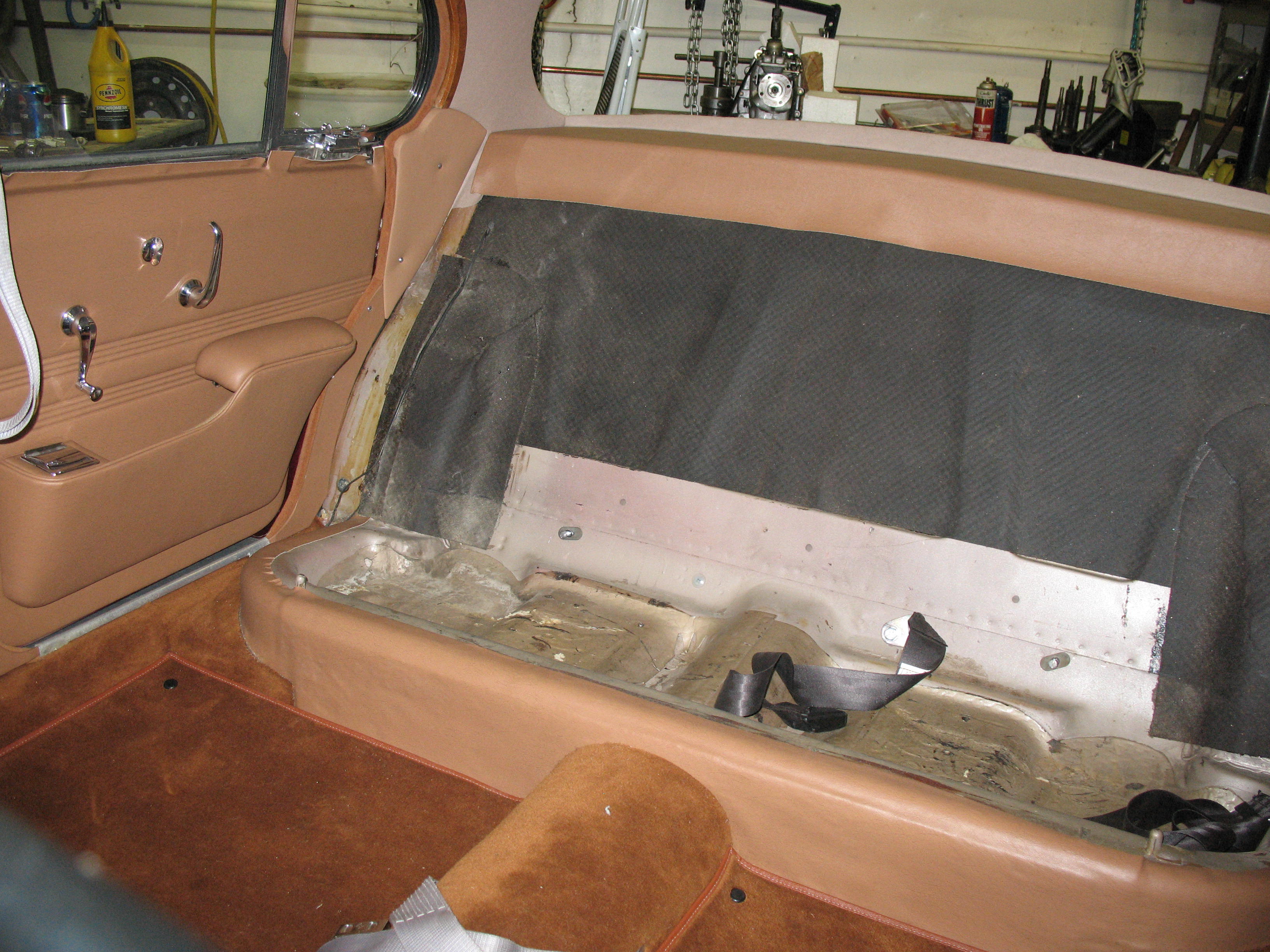

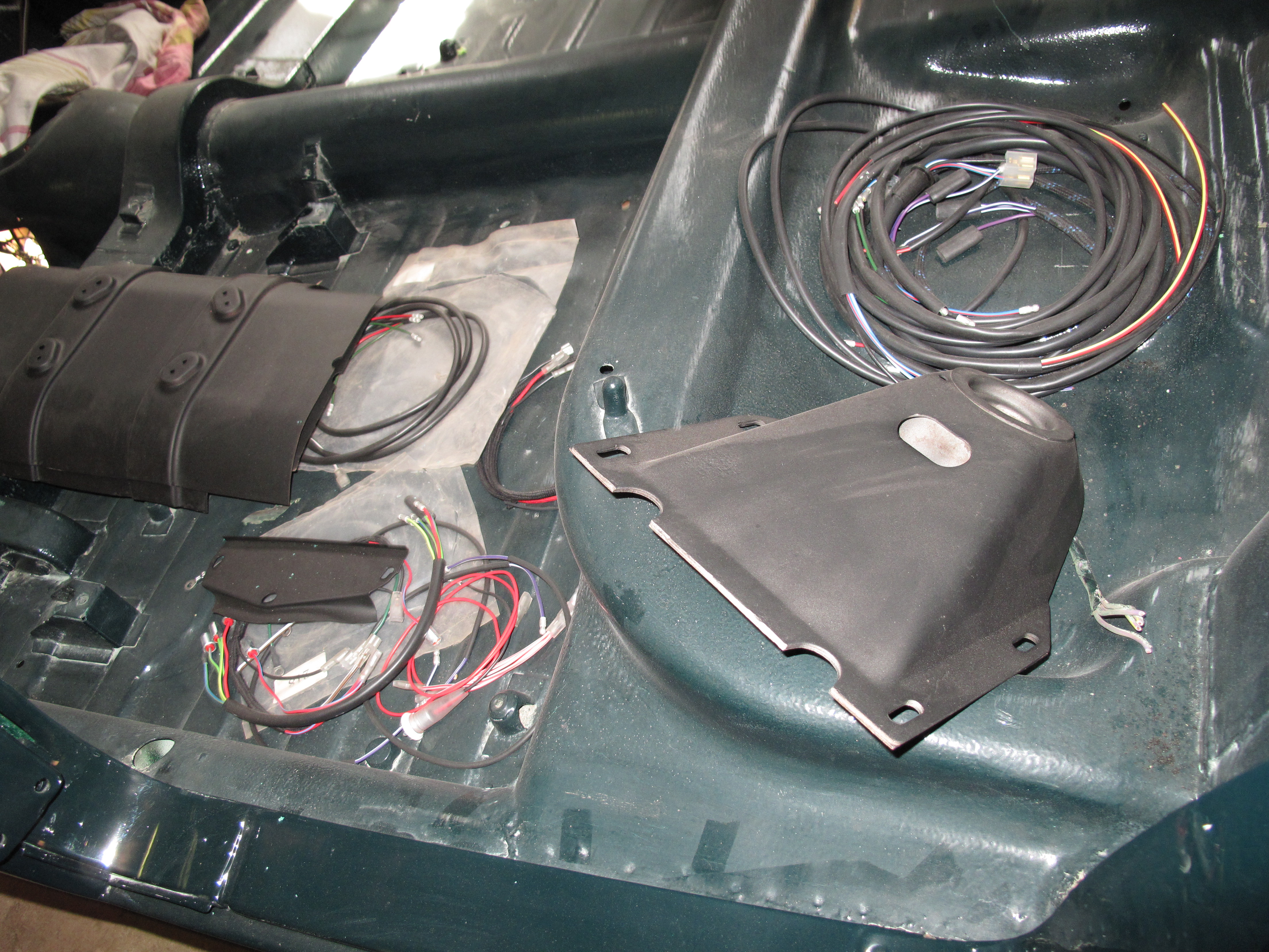

US car under renovation has them (download & blow up). Presume rivets are for exhaust shields. Not sure which "holes" you are talking about? Cuts in anti drumming pads?
That other car looks lovely.
My rear floor prior to Dynamat. Sorry pic not taken for this purpose. All anti drumming pads sand blasted off of my floor.
Yes, that's what I meant. I assumed they were holes, but I guess the anti-drumming material would have to have been cut like that to get it to stick. Curious the way oil has come through from the underside, though.

Orlando St.R wrote: Tue Mar 26, 2019 4:37 pm
The oil stains are possibly heat caused. The anti drumming material has possibly been heated up by the exhaust running beneath and caused the oil base of the material to liquify and run out?

Yes, quite possibly. Thanks for the ideas. I stuck some dynamat over it, so it's all gone away now. :)

It might also be ATF or similar from under the car that sucked through the rivet holes. That floor depression under the car that the exhaust shields sit in could well cause a pressure differential at speed.
Yes, it might be that too/instead. There is also ahead of that point a seam in the bodyshell, so I guess that might also be an entry point for ATF, of which there is a lot under my car.
