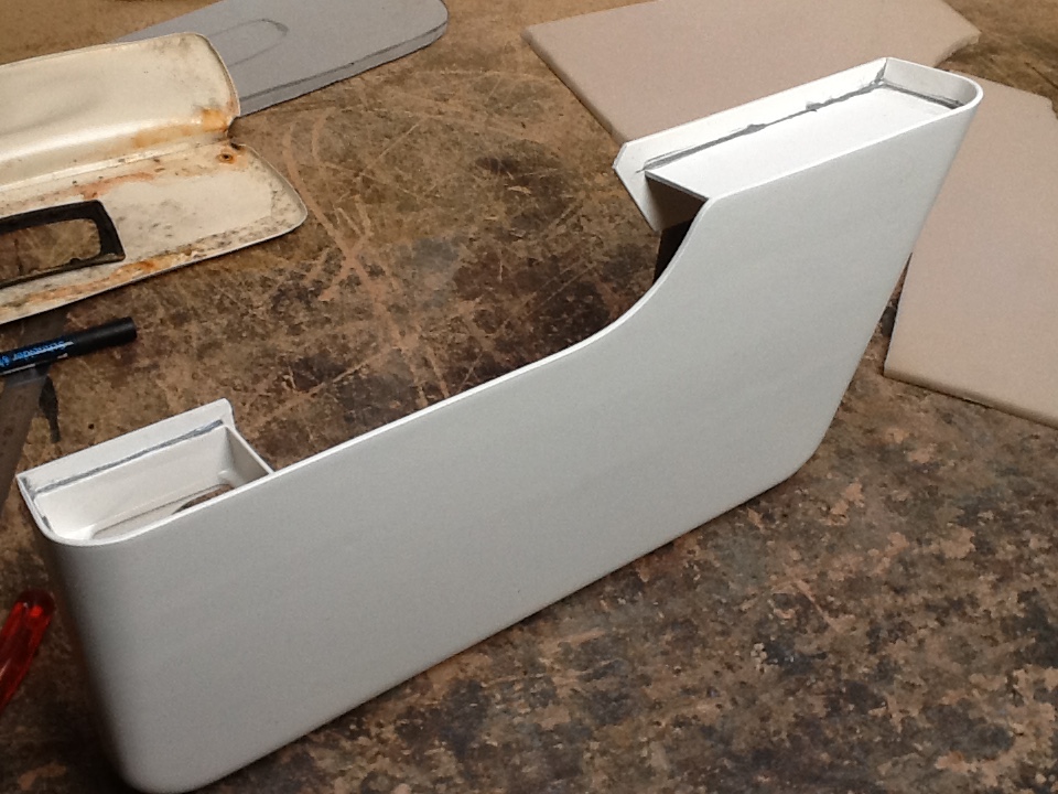

Getting rid of Jaguar's easily distorted press board rear armrests/magazine pockets & replacing with ones manufactured in ABS.
image1 (2).JPG (256.1 KiB) Viewed 5587 times
