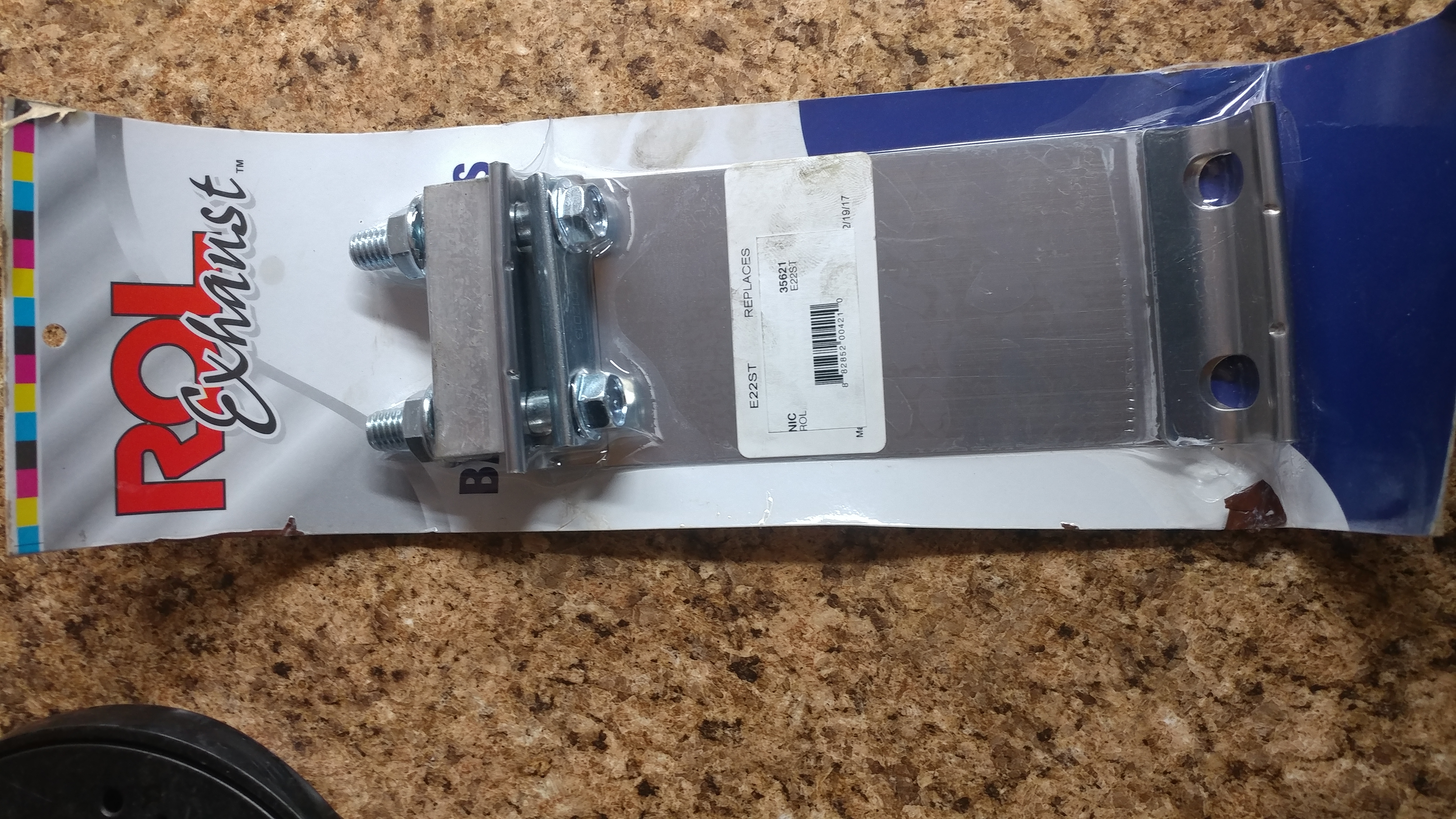

2) some of the new hardware that came with the Bell system. Not shown: the mid-hangers and the "U" clamps.

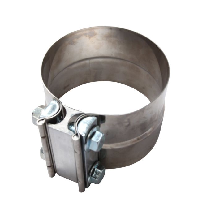

3) the Band clamps I used. 8 of them. Got them from a racing outfit.

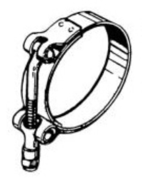

Talked to my guy today and he does not like the round band clamps. He uses these and has had great performance out of them since they cover more of the piping.

what is it? looks like a hanger.

This is a different one, but the same operation. Band clamp.....

that is a racing Sleeve clamp. Same thing as a Band clamp but it is overkill Joe. Not really needed.
You.re not going to be racing the car I hope?

The 2nd band clamp you have pictured is for joining to pieces of exhaust of the same size together. Ie, butting the two ends together as opposed to sliding one end of the pipe in to the next piece. They will work on inserted pipes which is what the first photo shown is possibly for. The "U" clamps that are traditionally used in this case due tend to crimp the ends of the pipes together meaning they are difficult to part should you need to take the exhaust off where as the band does not do this. There are reports on YouTube though that indicate that these band clamps do come loose with the heat expansion and retraction and do not have the capacity to tighten up fully afterwards.
I suppose it all depends on how many times you are likely to be taking your exhaust off. If its a stainless steel exhaust system the chances are that once it is on it stays on until the car falls apart around it.
