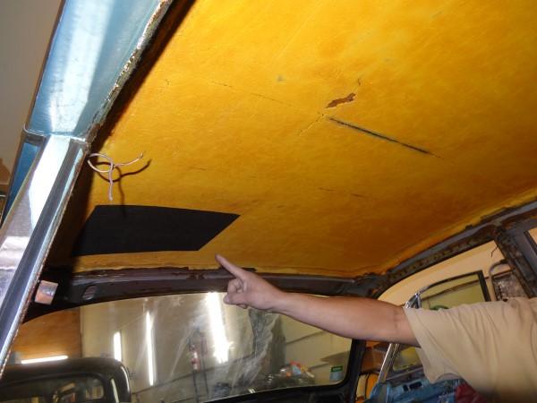

how exactly did you fix the headliner? did it have a fiberglass backing board?
did you have to remove the glass to remove it and replace it?

I stripped the complete interior out as I first coated the inside floor boards, sheet metal between trunk, with sound deadening paint, and Dynamat. Yes the headliner was removed and a new one installed. I had them do the entire interior which included reskinning the Vanden Plas front/rear seats, new door panels, carpet, etc. The glass was still in I believe.
