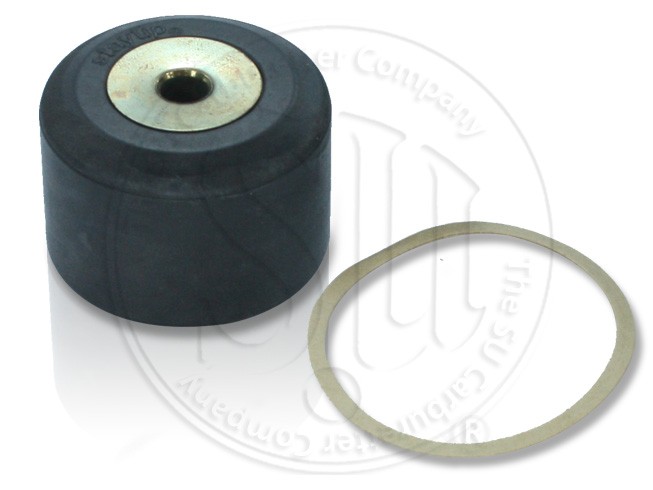

Cylinder head went back on today, I ended up replacing all the studs as I didn't trust the old ones with signs of pitting. While awaiting for them to be delivered I pulled the carbs apart to replace the float valves and found one of the floats to have fuel in it so was not shutting off the supply.
Re: Head Gasket Leak
That's looking very smart. That was fortuitous to spot the holed float while everything was apart. I switched to a stay-up float when I had the same problem recently.
Good to see her back together Nigel.
I think I must learn from you folks. I've recently had fuel filled floats & replaced with new brass. I think I must get some of these for the future. Hate it when the pump keeps running & I know I'm spewing fuel on the garage floor. So far new carb kits behaving.
