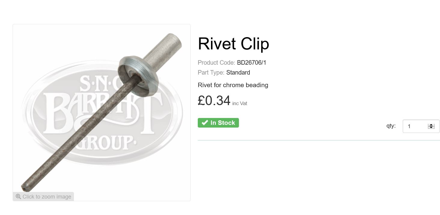

Your list is brilliant Glyn, yet another question I was going to ask is item 2 on your list. All of my chrome trims around the car are fitted as per the parts manual, however the N/S'R door trim has been fitted with the pop rivet alloy angled dome cap that holds the chrome trim in place. The door has been repaired possibly late 1960's early 1970's as you can see the panel beaters dolly marks inside the door to remove a scrape and then repainted and the trim re-fitted with the pop rivet caps.
These are much better than the original spring steel clips and more user friendly are these available in a fitting kit today ? if so from where, as I would prefer to use these when the chrome goes back on.

Dave ~ The original clips are rubbish. The plastic clips are rubbish but you at least don't have to rust protect.
This is what I used supplied by Barratts. They work very well & hold the trim strips securely.

First, thanks Glyn they are the pop rivets that are fitted to the N/S/R door, so still available, another problem solved. Second, regarding the grille securing nuts that's where a slim grandson with long arms comes in handy, as i would struggle to be honest.
Re: Refitting the chrome
Dave ~ just one tip with the rivet clips. They require a pop riveter with a very slim nozzle. I'm sure those with very fancy riveters with multiple nozzles will find the right size. We just put one of our nozzles in the lathe & turned it down to fit the rivet.
