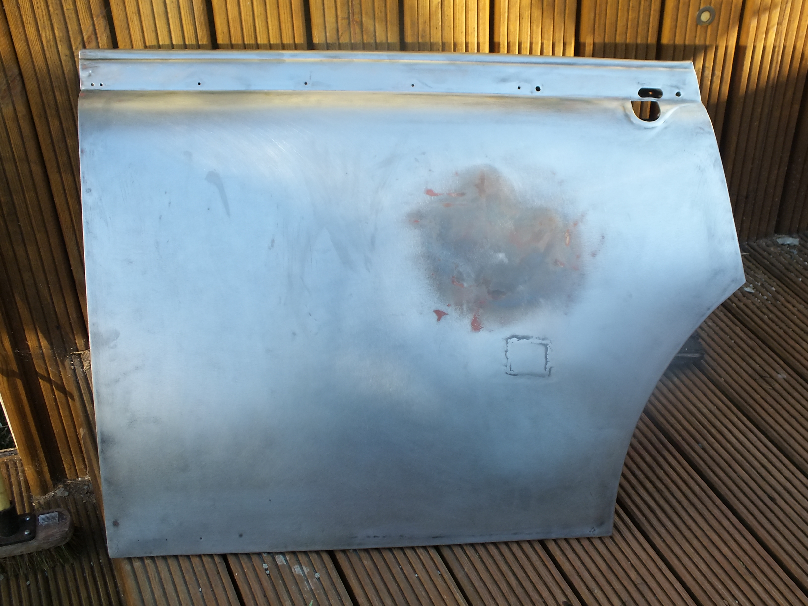

When you have the door stripped down also check the inside of the door skin. There is a sound anti drumming pad that is stuck to the inside of the rear door skins just where the chrome window section finishes. Water can run down this chrome section and the water soaks into the sound anti drumming pad. Over time the water held in this pad rusts the door skin from the inside to out. Treat this area as above with the underseal paint and waxoyl. Below is a picture of a door that has been poorly repaired by cutting out the rust and having a square patch welded in but it shows you where to look for the rust on the inside of the door skin. This is not how to repair the damage as this just warps the door skin. The dark area is where the door skin had warped due to the heat of the welded patch.
