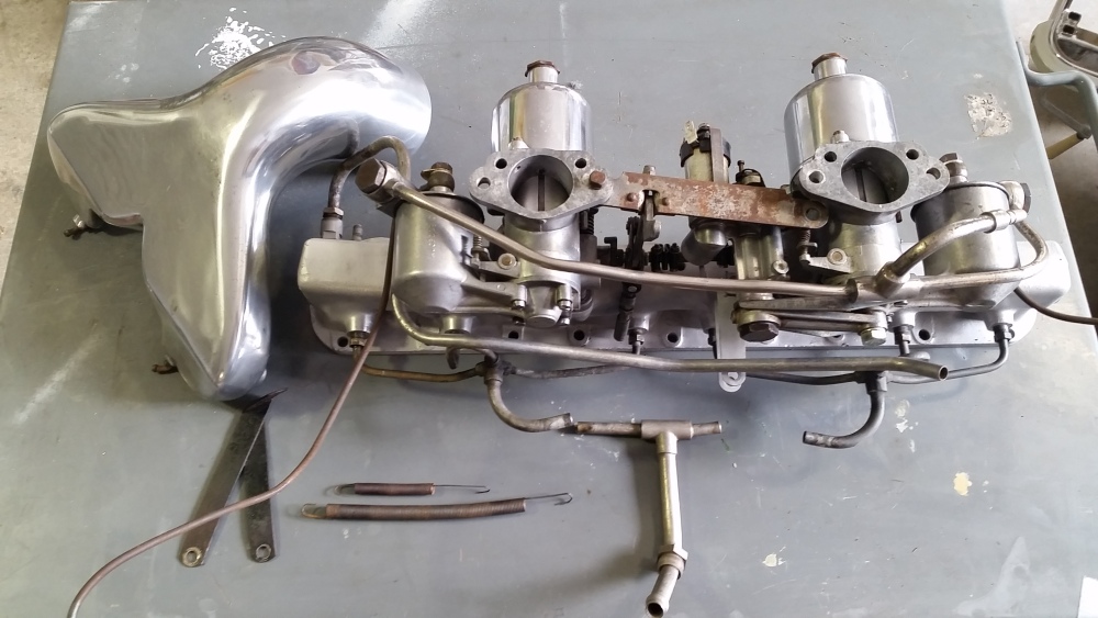

Re: Help with a non-starting 3.8
That's genuine. Let me see if I can find a pic.
Here with & without rubber pipes & clips.

Ah! Thank you, Glyn, the last of your photos explains a lot.
My setup, as found, is similar but not the same. My "metal T piece" comes vertically straight down from the A.E.D., whereas in your last photo the "T piece" is coming out horizontally. My "interconnecting rubber pipes" are very much longer. I'm not able to get a view of the small metal pipes coming out of the inlet manifold.
I'll attempt to get some photos later today, but meanwhile thank you for your photos, and putting my mind at ease. Looks like more rubber pieces for us Brits to worry about with E10 petrol. My new "E10 proof" rubber pipes are on order from Burlen

Mine is a 1967 3.4s and is set up the same as Glyn's photo. The "T" piece going in to the AED has to be undone to remove the carbs as I found you could not get a screw driver underneath to remove the Jubilee clips on the lower rubber pipes. The problem comes when refitting and you are trying to line up the "T" piece thread with the AED. I found the easiest way to connect this "T" piece was to do so before you tightened any of the nuts holding the carbs in place. Sometimes I even connected the "T" piece before even putting the nuts on the studs so you had enough movement to get the thread on the "T" piece started.

Cass is spot on and absolutely correct about leaks on the fuel supply cross piece from carb 1 to the AED. Mine is the same set up as above but I used two carb sets to achieve one that did not leak at the AED fuel supply cross piece. For the life of me I could not figure out why & did not want to waste time diagnosing. It worked & the carbs were already mounted when we discovered the leak. Fortunately had plenty of spare fibre washers. Battled a little to replace the cross feed with the carbs already mounted. Used some language I would not want others to hear.
Regarding T piece side feed vs vertical feed to the AED. I guess there were variations on the theme over time.

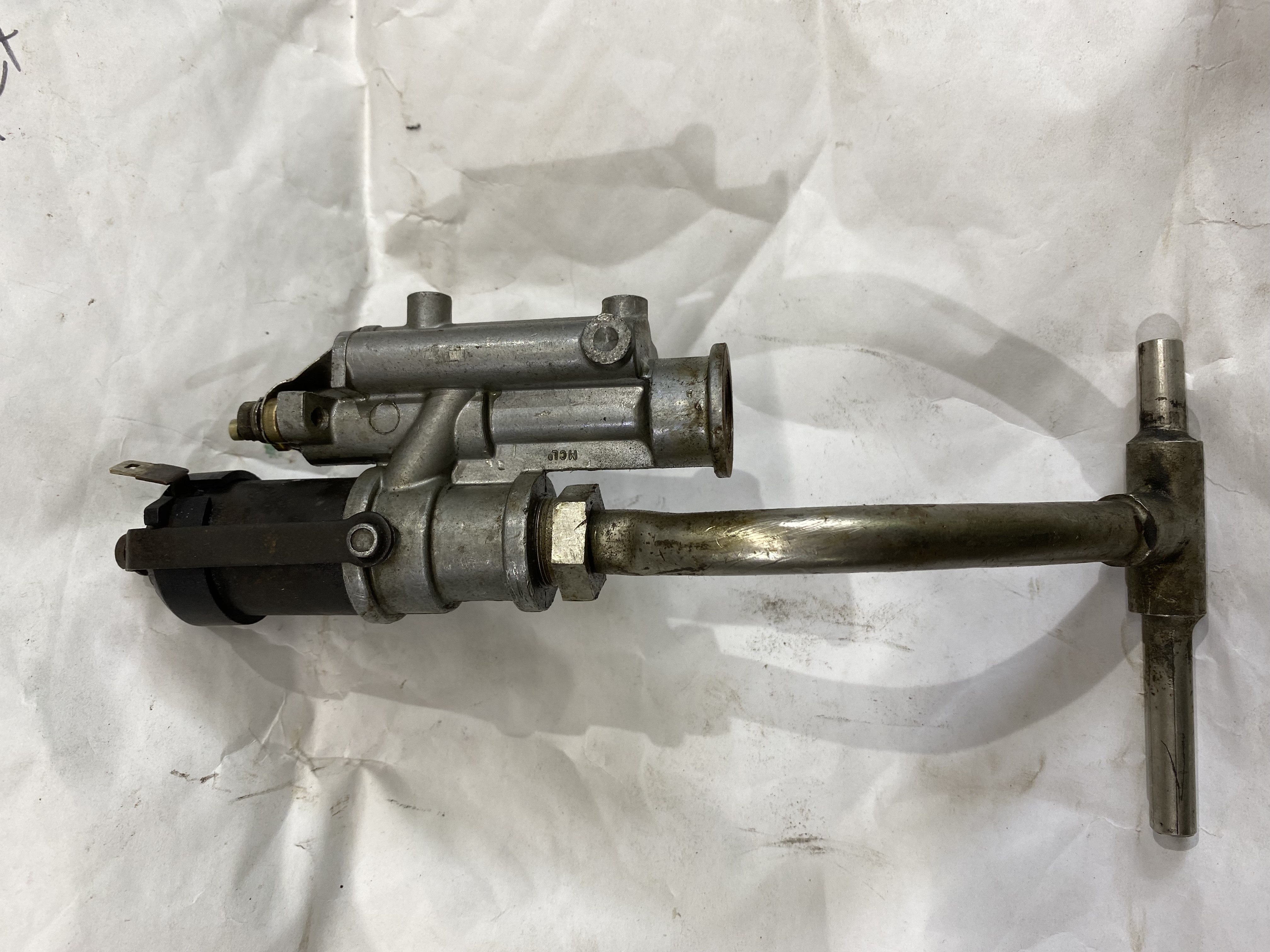

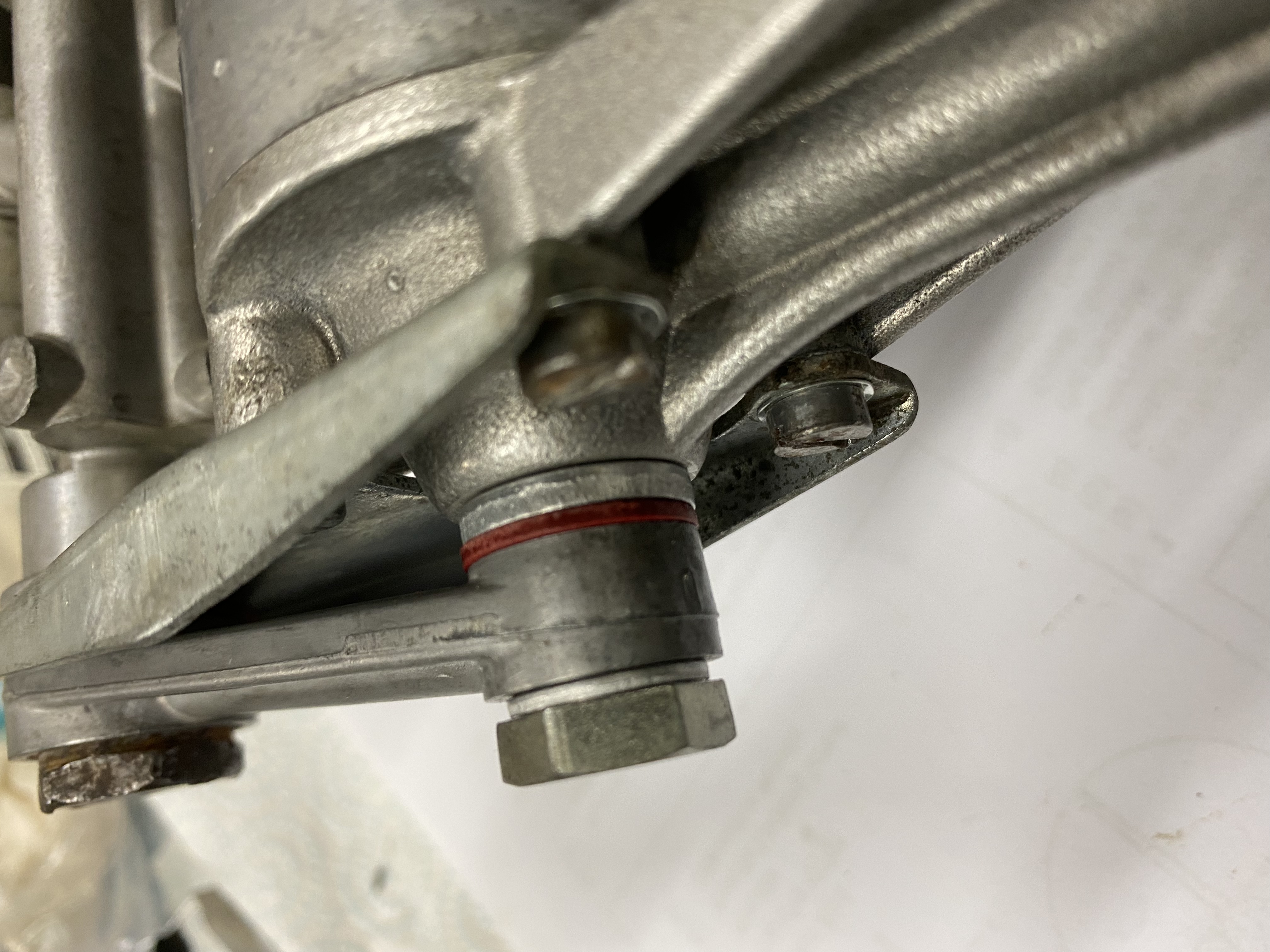

Many thanks to all those who have contributed to this thread so far. As there seems to be so little written information on the A.E. D. and it's plumbing, I thought it might be useful to try and pull all the known information together. Future "S" type owner/ mechanics may thank us.
I have several queries relating to the bridge piece between the front carb and the A.E.D. On my car, the side "flanges" of the bridge were pointing downwards, in Glyn's photos they are pointing upwards. That is no big deal, but I would like to know which one is correct.
Query 2 relates to the washer arrangement on the banjo bolt connecting the bridge to the base of the front carb I'm confident the thicker Ali spacer sits above the bridge, and the thinner one sits beneath the bridge, but where should the single fibre washer be placed? I would have thought there should be a fibre washer between the bridge and both Ali spacers, but there is only one suitable fibre washer provided in the overhaul kit from Burlen.

I suspect my A.E.D. Is not original, as the inlet manifold pipe exits vertically downwards, and so is out of line with the metal pipes coming out of the inlet manifold ( see Glyn's photos earlier in the thread.)I have several queries relating to the bridge piece between the front carb and the A.E.D. On my car, the side "flanges" of the bridge were pointing downwards, in Glyn's photos they are pointing upwards. That is no big deal, but I would like to know which one is correct.

Great photos to show the AED. I just wish SU, or Jaguar, had created a vent line, or lines, from the two holes under the triangular shield to the air filer so that fumes did not escape into the engine bay on hot starts on very warm days creating a gasoline odor .
