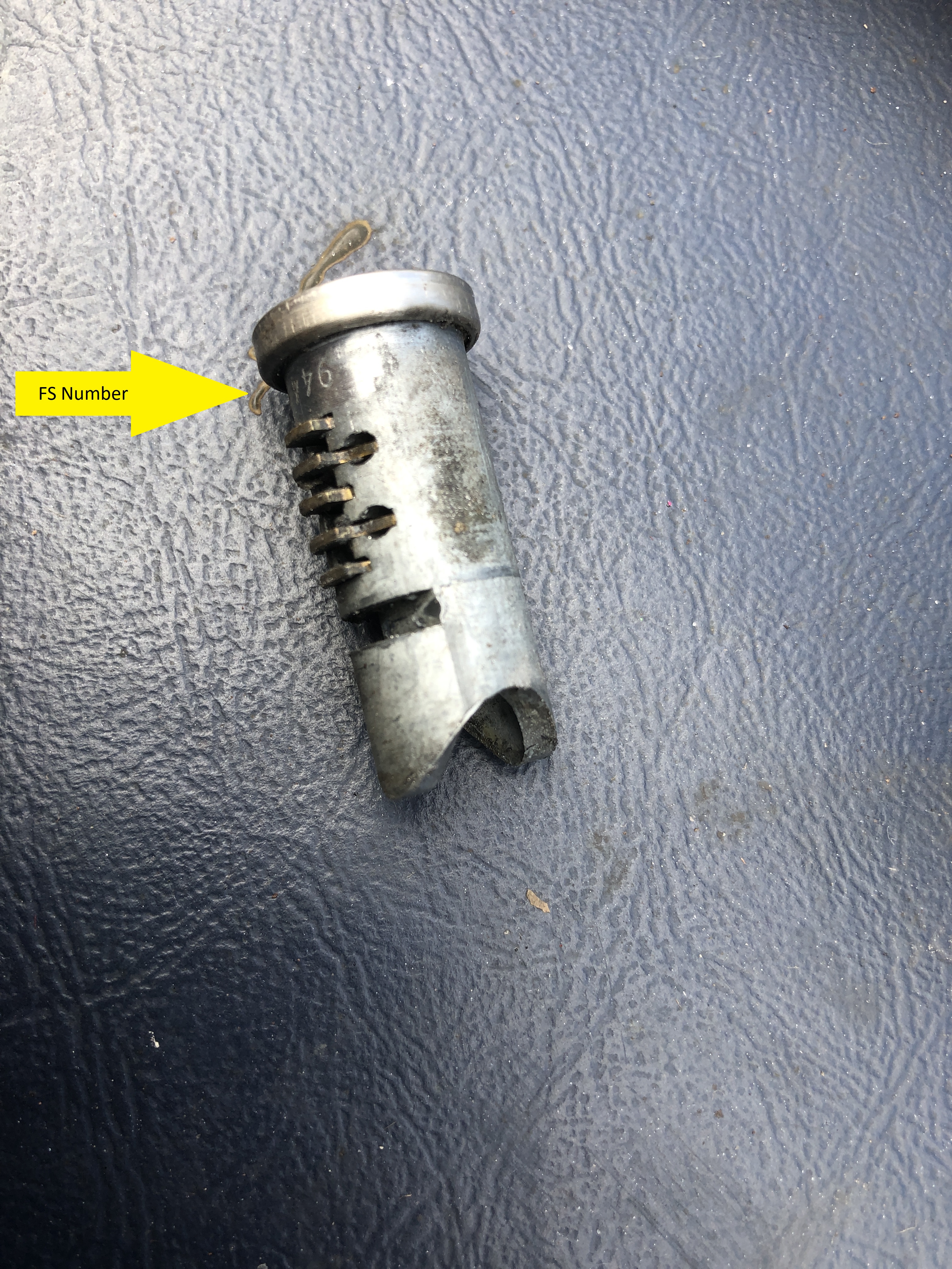

In my box of many things I found a spare boot locking mechanism over the weekend and decided to pull it apart to find out how it worked.
I did not have a key for this one so could not see how it worked without taking the lock out. There is a small locating pin at the base of the lock under the operating handle which you need to drive out. This releases the lock which can be pulled from the barrel.
The lock is unique to the boot in that at the base of the lock there is a section that allows the lock, when turned to the open position, to push the internal mechanism forward so it engages. When turned to the lock position the lock is disengaged as the mechanism springs back towards you.
If you have lost your key and the boot is locked you should be able to get a pin driver into the side of the lock to drive out the small locating pin. I used a centre punch to start it then a 3mm drill bit tapping it with a small hammer. Once the location pin has been driven through and the 3mm drill bit removed the lock can be removed from the barrel. You will now find that by pushing a screw driver in to the hole to push the mechanism forward the boot can then be opened.
Having removed the lock on the side there is a number somewhere in the region of 800 to 999. This is called an FS number and by going to this company https://www.replacementkeys.co.uk/union ... F0QAvD_BwE you can put in your FS number and have a replacement key cut. They will also cut spare keys for the ignition and doors.
I think I am right in saying that a new Jaguar came with two keys both FS keys with different numbers. One key fitted the driver’s door and the ignition whilst the second key fitted the glove box and the boot.
