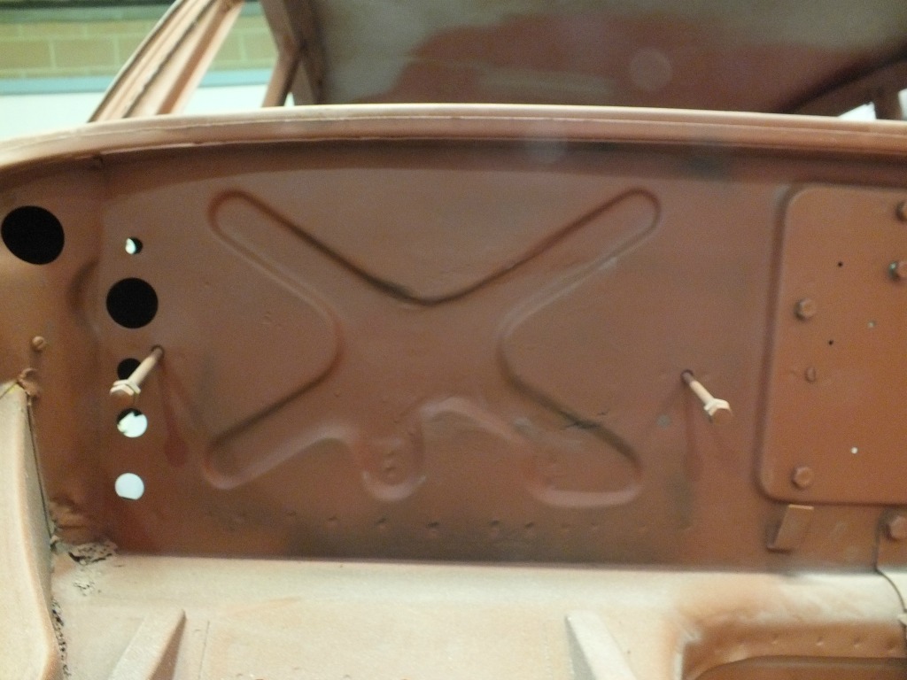

Just for your information Scott that felt pad you have on the bulkhead behind the battery needs to go. When you open the bonnet on a rainy day water pours down the back of the battery onto this pad which then stays wet for a long time. Being wet and in contact with the metal of the bulkhead you will find it rusts through over time.

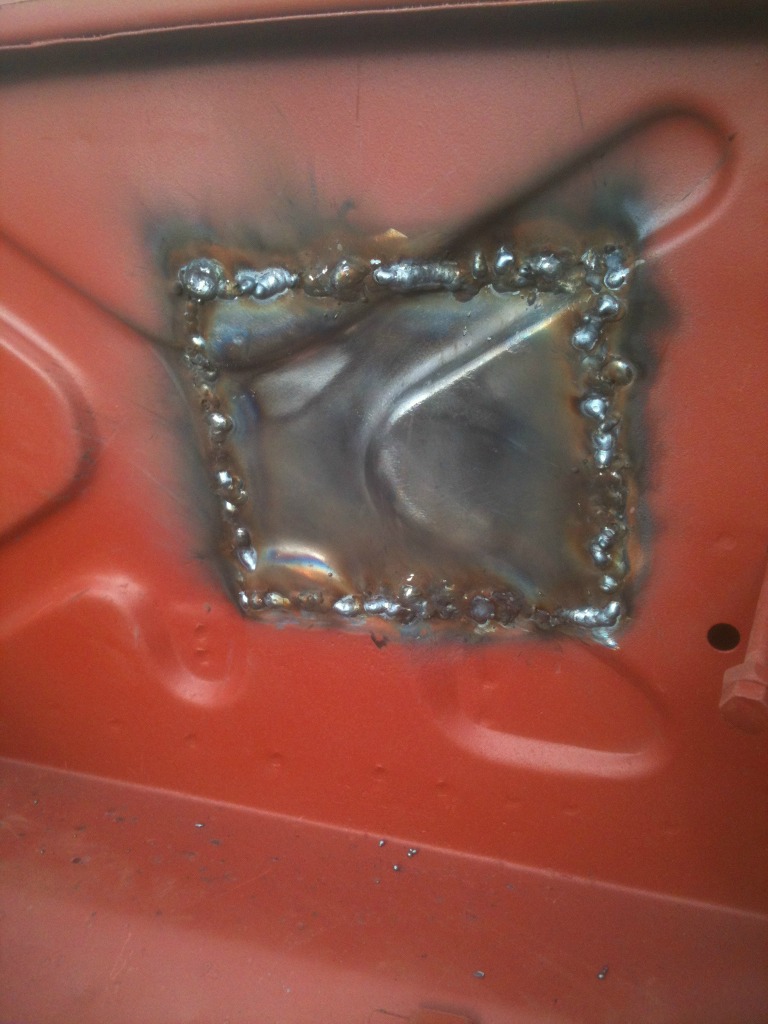

I had to make a repair to my bulkhead during me rebuild as it had a great big rust hole in it. I have replaced my felt pad with a closed foam pad which does not retain water but protects the bulkhead from damage should the battery try and move. Please excuse the welding but I was new to it and this was outside in an open area with a breeze blowing.

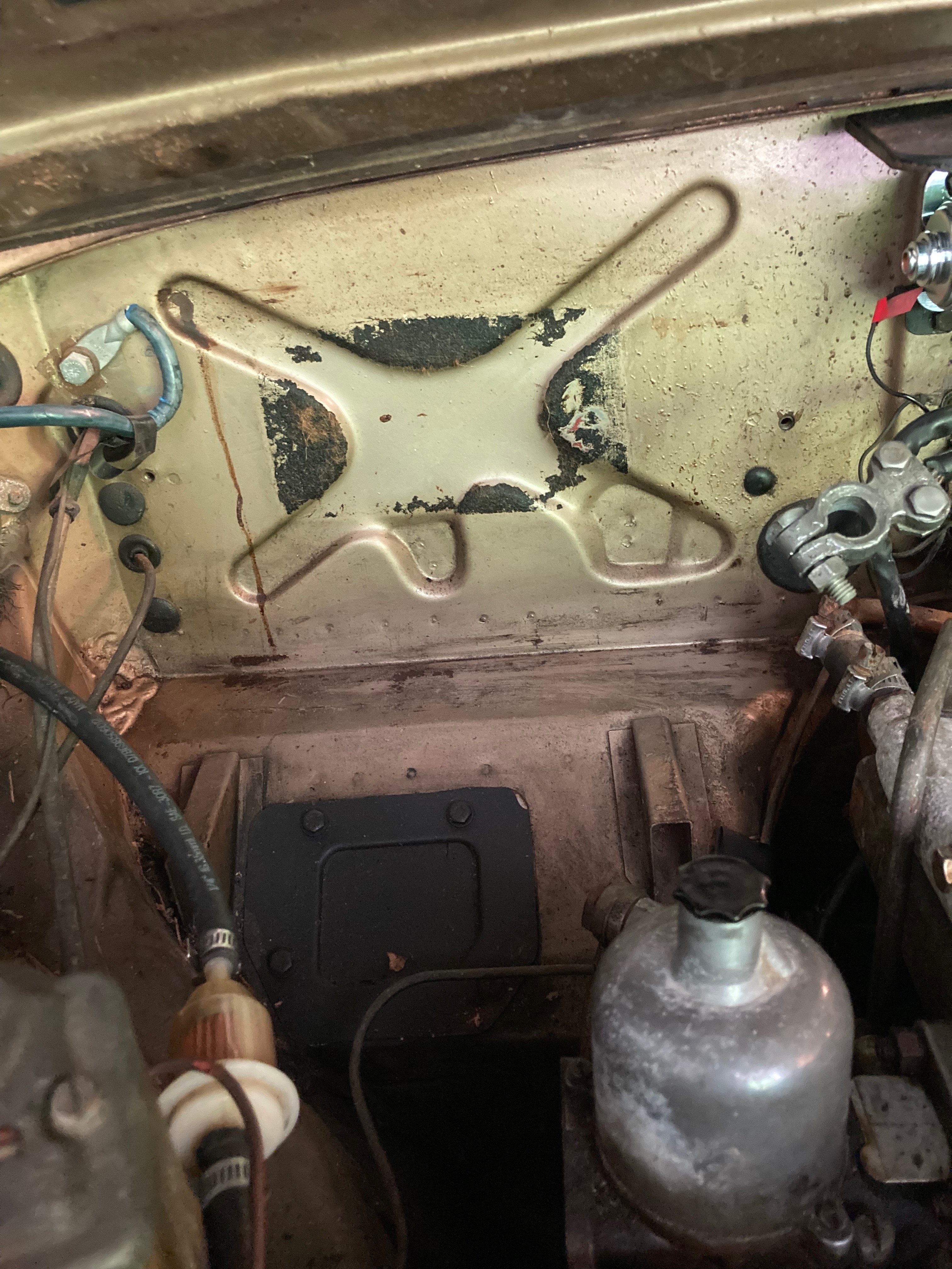

Re: Does anyone know where these wires go?
Cass, thank you for the advice about the felt pad. I pulled it off to see what was behind - fortunately no rust. This car seems to have spent a lot of time baking in the sun, but must have been kept fairly dry.

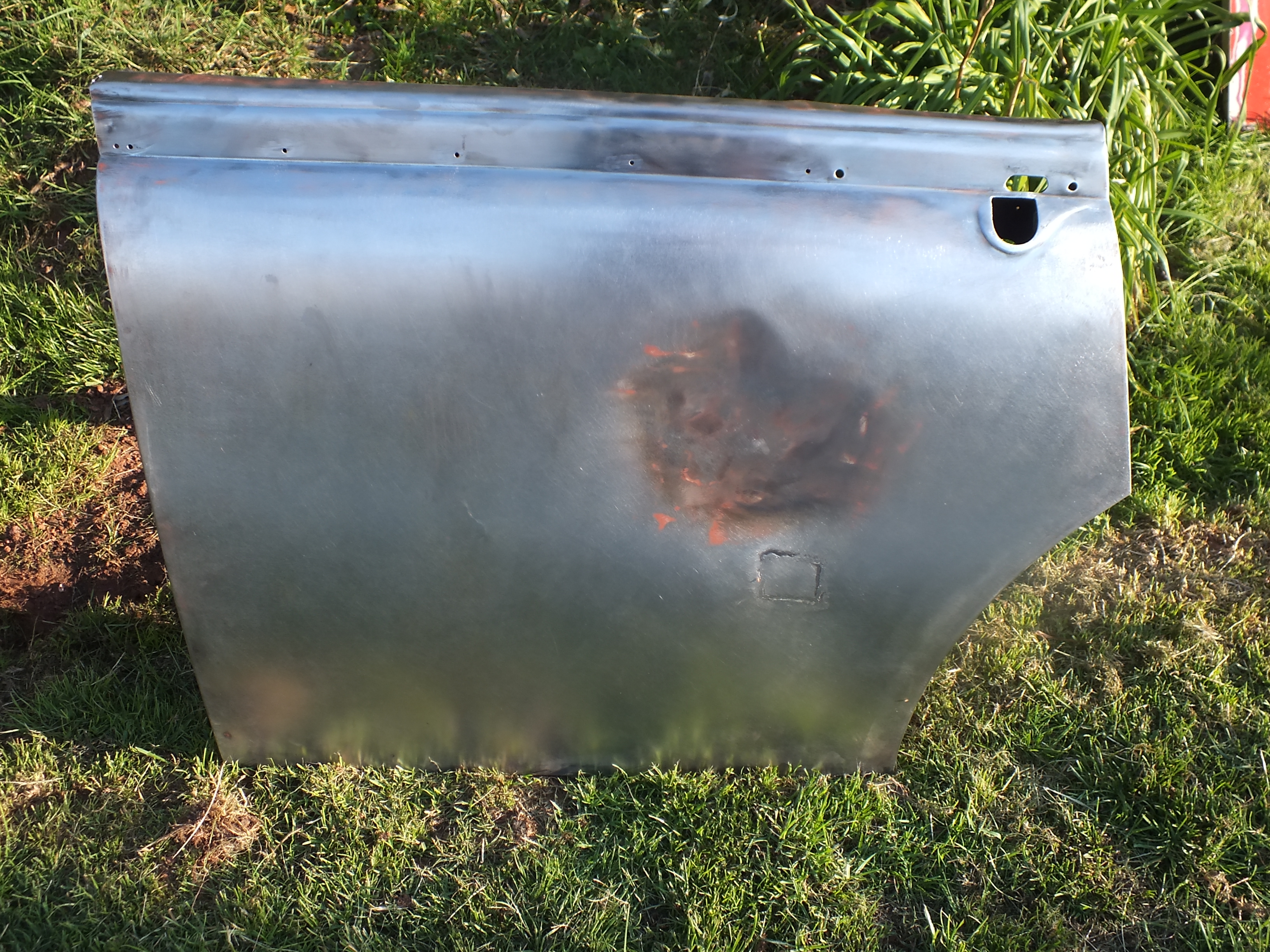

Inside the rear doors where the chrome window channel is bolted to the inside of the door. Here you will find another felt sound pad. Water runs down the channel onto the felt pad and the door rusts from the inside to out. Very common on a Mk2 and S type. One of my rear doors had been "repaired" before I got to it. They had welded in a small square repair patch which had warped the door skin. Took ages to repair this.

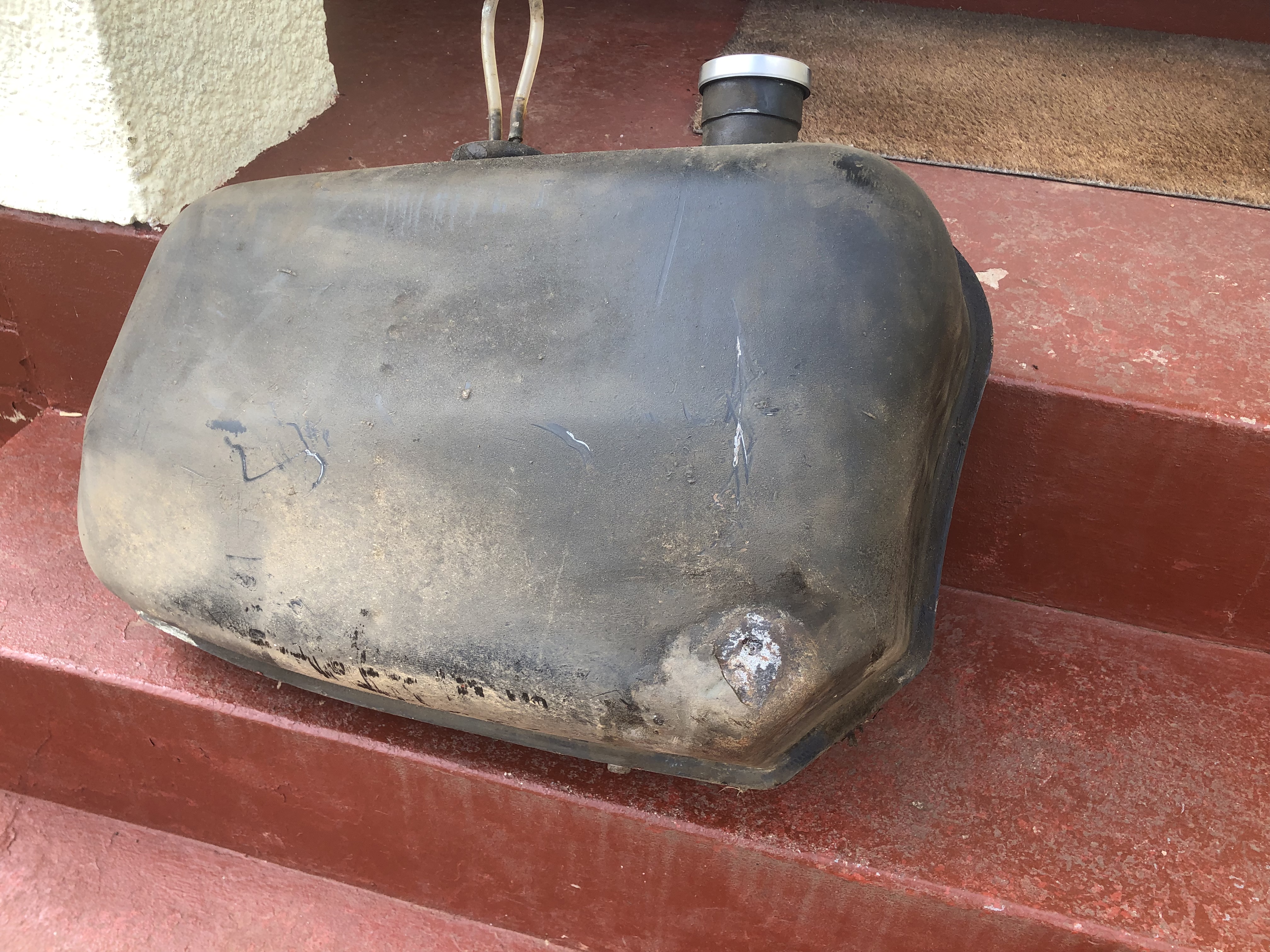

Lastly the front leading edge of the fuel tanks. All the detritus from the rear wheel gets kicked up into the face of the fuel tank and causes wear and rust. Sometimes the pin prick holes are too small to actually see the fuel leaking but you have a constant smell of fuel vapour in and around the boot.

The rear door felt patch that pads the bottom of the window channel from the skin is very common. Soak with Tectyl.
