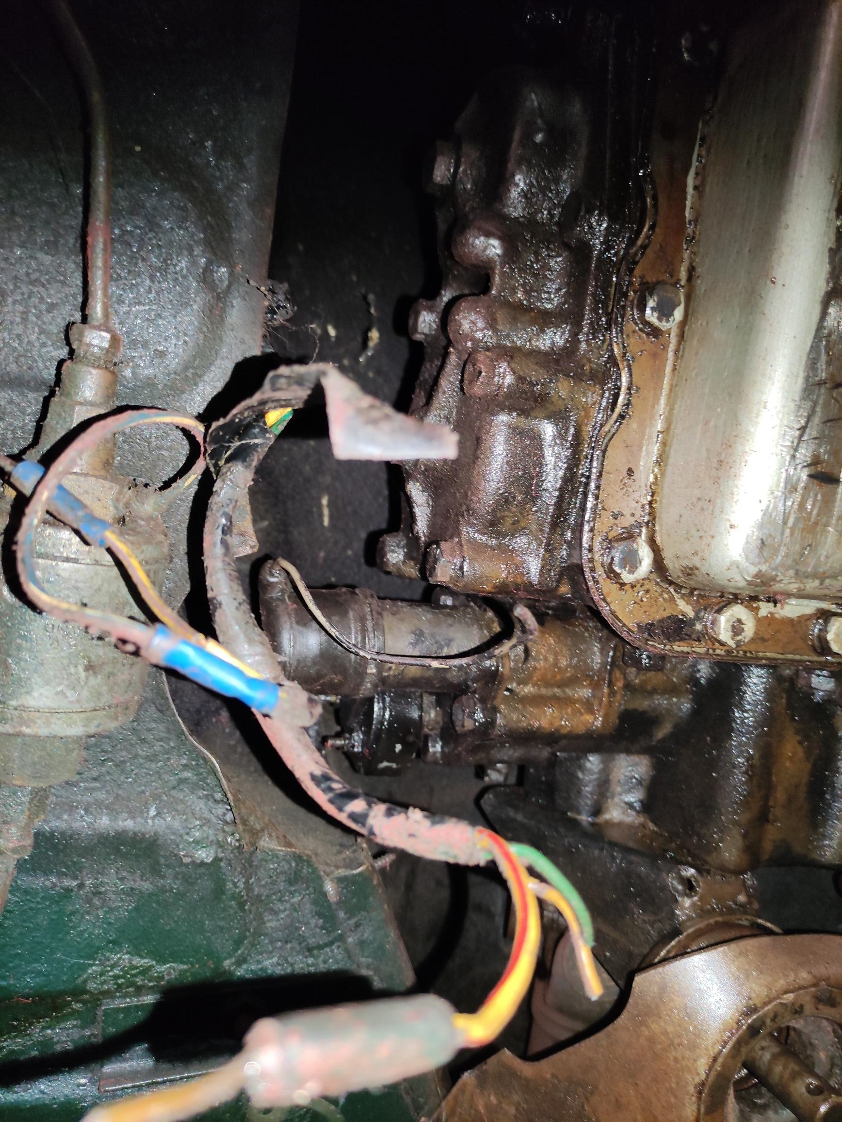

hi all, while mucking about and sorting a few other things i found this under the car.
by what looks like the overdrive unit there are 3 wires (bottom of picture) and a wire from what i believe is the overdrive soloniod that goes to no where
can anyone show me where there meant to go at all.
Re: gear changing early
If you have an Auto box I doubt this is an overdrive solenoid. I am only guessing as I have a BW35 box not a DG250 but could this be the "speed hold". Not sure how it works or if I am even correct but it might jog someone else's memory.
The item on the left that has the dirty wires and blue connectors attached is the Anticreep devise.
The gearbox looks like a DG and the solenoid is the intermediate speed hold, the item bolted to the floor is the anti creap device as Cass said so definitely not a manual overdrive.
Looking at the wiring diagram on this site the yellow/purple and green go to the anti creap switch and the yellow /red goes to the solenoid. Unfortunately I can't verify this on my car as I put the DG box in the skip decade's ago.
