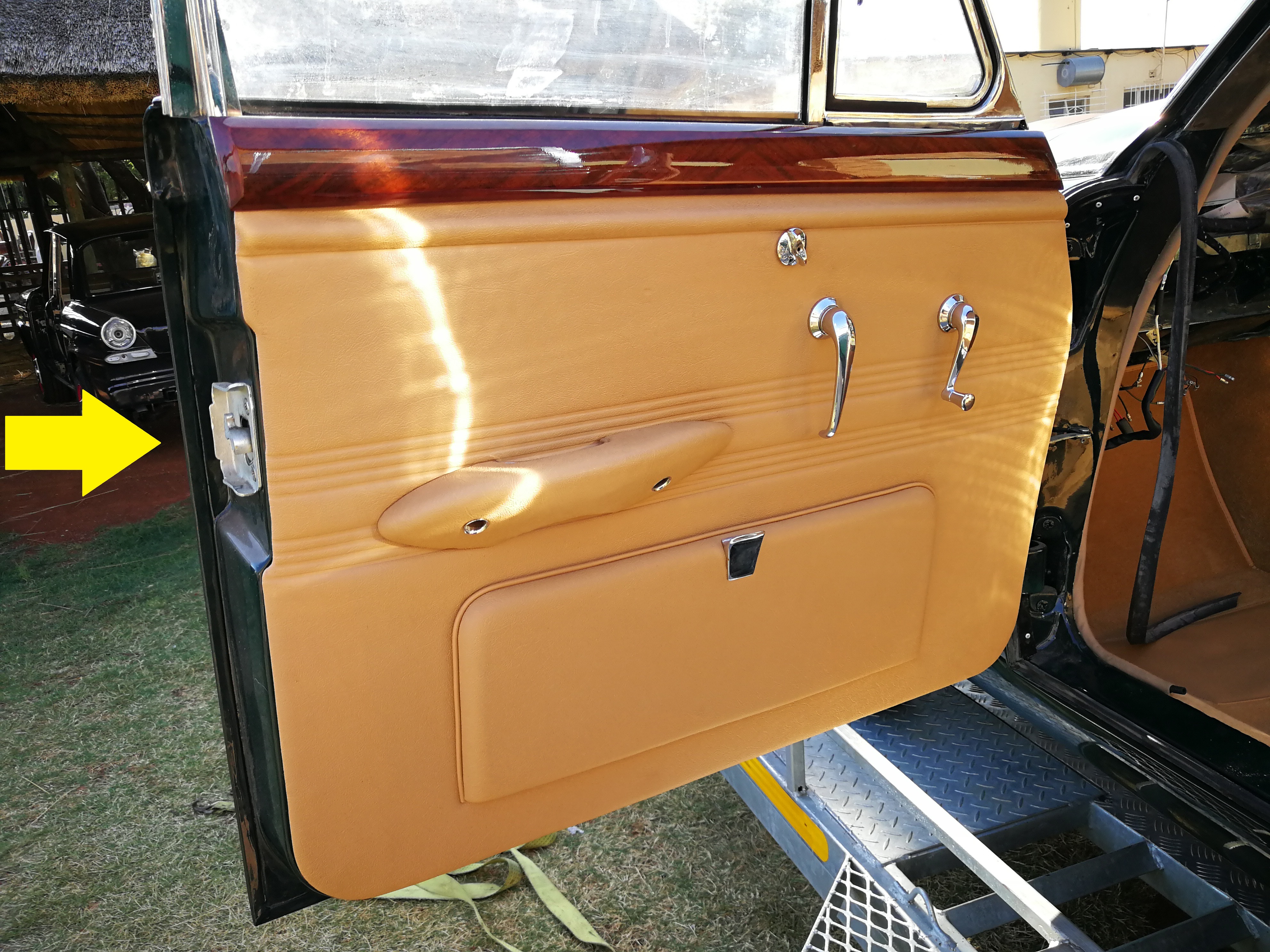

I think one has to be practical. There are items that are mainly hidden & you just want to stop future corrosion. Then there are visible items like the door locks that you want to look decent.
IMG_20180119_162722 - Copy.jpg (3.23 MiB) Viewed 2982 times
